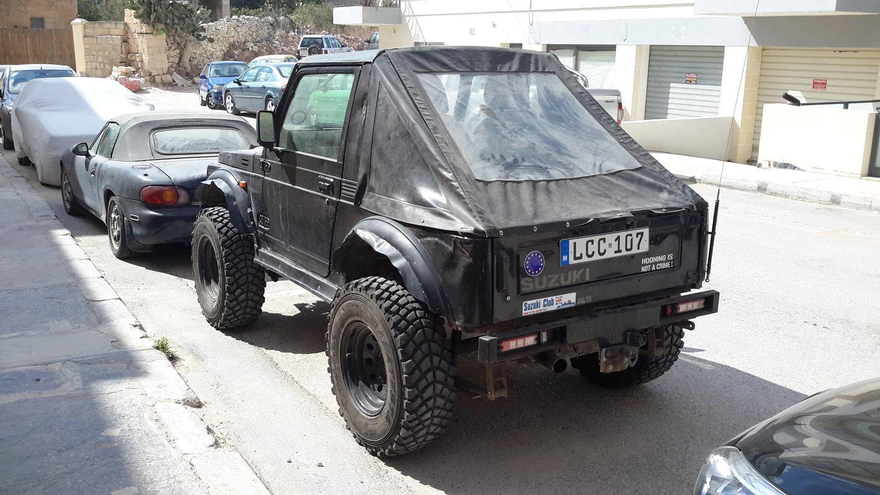

Post by twiss » Fri Jun 24, 2016 6:22 pm
it is indeed... technically it shouldn't have the UK plates on it anymore as its on a maltese chassis now... but i haven't bothered to take them off yet
looks like its driveable-ish now so hopefully people wont park in front of the driveway!

Post by SlimGrim » Fri Jun 24, 2016 7:15 pm
Looks beasty! Silly question cause I'm uneducated, why do people use flexy plastic mudguards instead of wide rigid ones? Is it cause they can take a beating and just flex as apprised to cracking?

Post by twiss » Mon Jun 27, 2016 3:13 pm
Sorry mate thought I had already replied to this but I guess not!
I went for this plastic because I often rub the tyres and arches up against things to get through small gaps.
The floppy plastic arches can fold all the way underneath the arch and then come back out again with no damage.
Also... if i do trash them I can just buy some new plastic for a few quid ;)

Post by zook123 » Mon Jun 27, 2016 3:33 pm
SlimGrim wrote:Looks beasty! Silly question cause I'm uneducated, why do people use flexy plastic mudguards instead of wide rigid ones? Is it cause they can take a beating and just flex as apprised to cracking?
Have you seen the price of the rigid ones!
I forgot who on here had them, but it looked like plastic barrels!

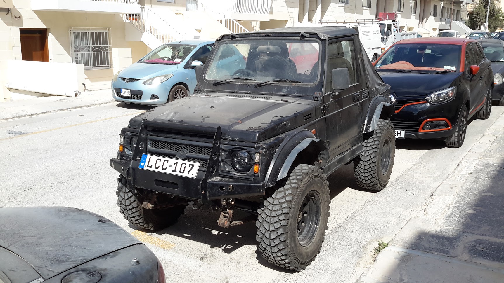

Post by twiss » Wed Aug 03, 2016 3:18 pm
Still needs a clean and some bodywork doing but its on the road legally!

Post by SlimGrim » Wed Aug 03, 2016 10:52 pm
That's awesome! Where are you gonna mount the plate when you put a winch in? I want this bumper eventually but that is my only concern haha

Post by twiss » Wed Aug 03, 2016 11:29 pm
I'm hoping that a 9500 Short Drum winch should fit in there behind the plate... but time will tell!
