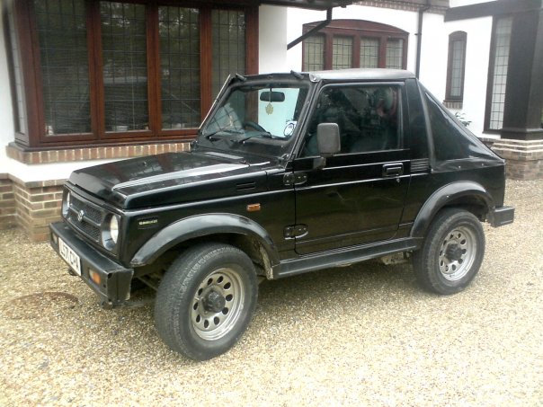

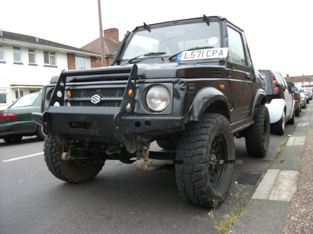

When I got it
Here's the beast when I got it!!!
I paid a whopping £700 for it, with a full years MOT (minus 2 days) and a years tax as well!!!
Bargain!
It was totally standard when I bought it, except for the white fibreglass hard top that came with it!

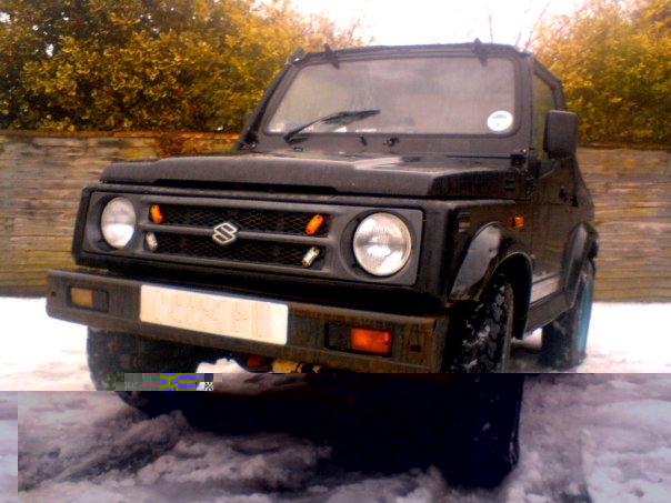

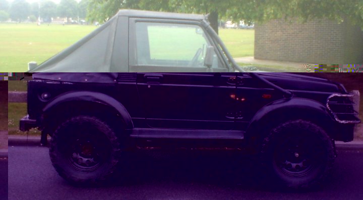

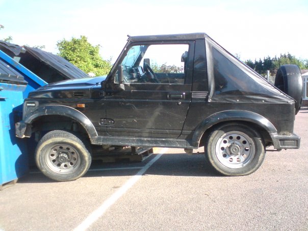

Washed and soft top put on
I gave it a good clean and some polish to get it all shiny... then put my fastback roof on it!
I had the roof from my previous SJ already... originally came from Monsoon soft tops for £170

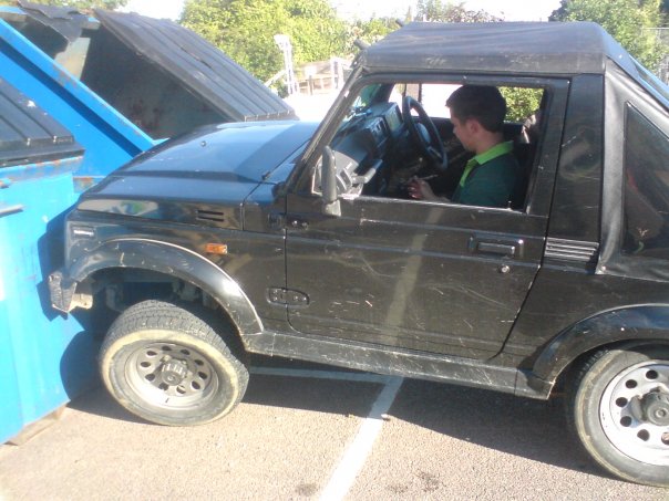

Testing Time!

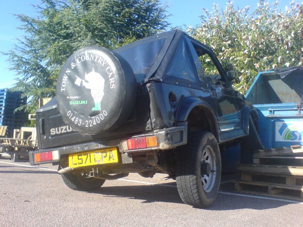

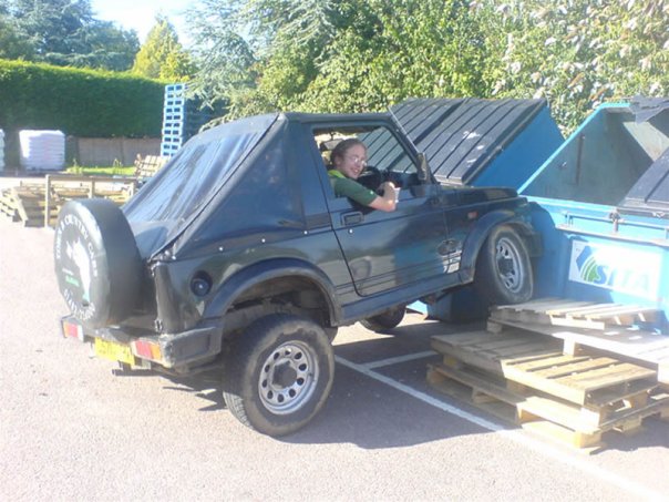

I thought as it was sunny I should get out there and test it... so after work me and my mate made a pallet ramp to drive up :lol:
It actually had some reasonable flex... shame about the crappy tyres though!

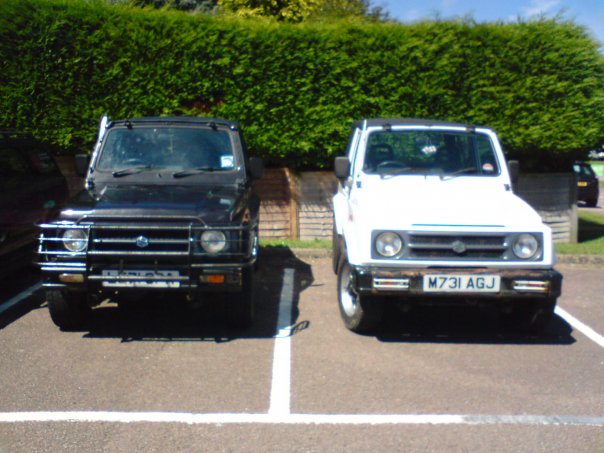

Here's my mate's SJ that we were testing it with...

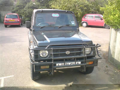

Next comes Armour!

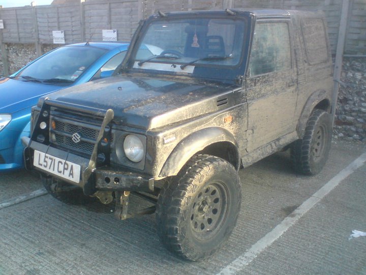

I'd had this SJ a month or two at this point, been offroading around... and decided that I needed some frontal protection.
I just went and got some standard bullbars. Popped down top Rhino Ray's in Brighton... he was in a good mood that day and I got the bullbars for £10!
Mind you, they weren't exactly in mint condition, but I thought I would just be crashing them into stuff anyway!!!

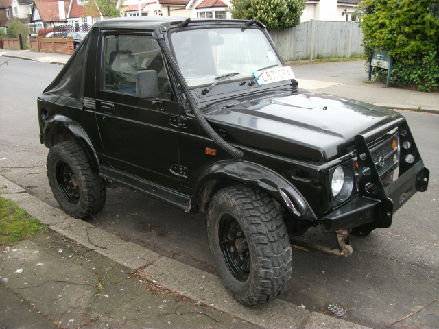

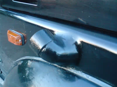

Snorkel!!! I seem to like driving in deep water, so I though a snorkel would be a good idea!
I got myself a length of aquarium water hose... it's about 45mm diameter, very durable, yet flexy enough to take a few tree hits.
One of my mates gave me a hand with the connector in the wing.
A B&Q pipe elbow, some filler and some paint later...
... but while I had the paint out I thought I would do the wheels as well!!!
Looks much better!

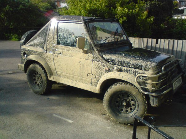

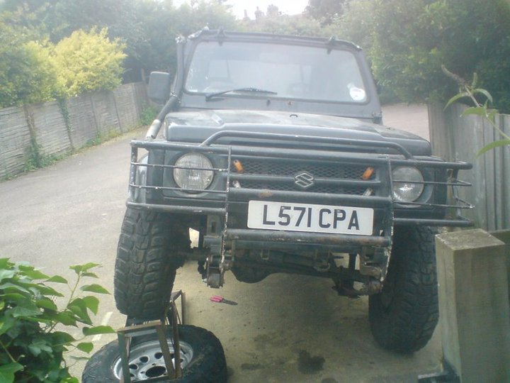

I attached the snorkel pipe but didn't get a piccy of it... until the next day, after a night out on my mates farm!!!
We had fun that night :twisted:
You can see the snorkel pipe in this pic

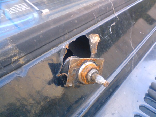

Here is one of the not-wear-and-tear breakages!!! I was trying to push a tree branch out of the way with my windscreen and look what happened!!!
I managed to rip the wiper arm out of the windscreen surround! Ooops! :hahaha:
I went to a metal workshop nearby, helpfully recommended by turbo-tom, and got a nice long offcut bit. I then just rivetted it over both the windscreen wiper holes, drilled it, painted it and put the wipers back on!!! Theres a pic of it unpainted later...

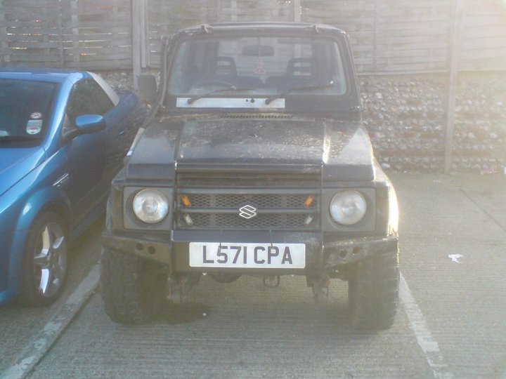

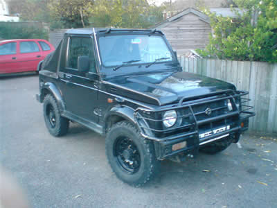

Heres a picture pre-MOT time a couple of years ago!!! I didn't have an MOT at this point so missed out on driving around in the snow that year! :(
I had to take the bullbars off as I had knackered the mounts!!! (had a slight tree crash incident) ;)
Also note the turquoise wheels I borrowed off a mate for the MOT... Mine were knackered!!!
Note that I hadn't put the other wiper arm back on yet ;)

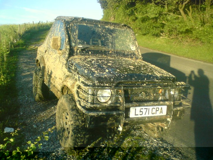

Some off road action
Obviously cos I'd just got some new MTs I thought I had better take it out for a test run!!!
This picture I took at about 6am on the way home after the whole night out...
Did a few byways, and found some fords... was a good night!!!

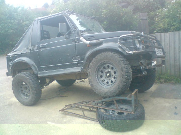

More Flex!
I decided to make a ramp and drive up it... Just to get a few poser snaps!
Prizes for if you can guess the standard SJ part I borrowed for the snorkel ;)
Also see the nice lack of paint on the bullbars... they are getting a bit battered by this time!

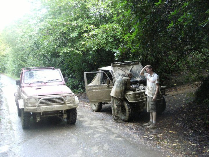

After a great day out at the Piccadilly Wood off road site with "Jonalong" from difflock, here's a very muddy version of me fixing my throttle cable!!!
Nothing serious, just the cable clamp had broken off the end of the throttle cable... I borrowed the choke cable one for the drive back :)

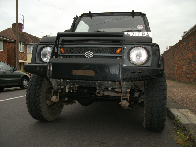

Next on the list was a new front bumper! I had absolutely annihilated the bullbars by this point!!! I was reversing past a steel post, caught the edge of the bullbars and managed to bend them down forward to about 45 degrees :lol:
I "fixed" it by ramming a bit concrete block until they were at the right angle again, but the bullbar was FUBAR by then!
I got the bumper for £170 from a nice chap from difflock... I liked it because of a) the price and b) the looks. I always liked the calmini bumpers, and this one is virtually identical to the C3 bumper then make... and the offroad armoury bumper!
Here's the winch bumper... the fairlead hole has the number plate over it in this picture though
here's the Calmini bumper...
off road armoury one

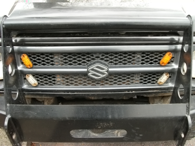

Front sidelights/indicators
Where I've taken the bumper off i've obviously lost the standard side lights and indicators. So I got these LED ones from ebay... You may notice they are the same as the fog/reverse lights on the back... Just in white and orange. I've just attached them to the grille with bolts and washers!

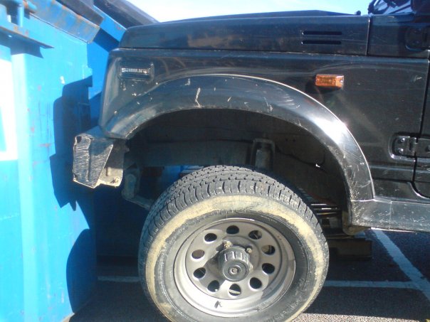

Suspension Lift
Well you may have noticed in the new tyres picture that I had some terrible shackles on there!!!
I traded a set of awful 3" lift shackles with my mate matt aaaaages ago... I think I traded them for some beers or something :hahaha:
When I put the tyres on, first off they rubbed on the arches and the bumper. Bumper was an easy fix for the angle grinder ;)
Arches were slightly different. So I put the 3" shackles on just as a temporary measure to clear the tyres!
That lifted it up OK, but then I noticed that the tyres rubbed on the springs on full lock...
Rrrrrigh what can I do about it then... So back to ebay I went. Found a guy local to me selling some. They didn't sell as he refused to post... so I got the spacers (and a full exhaust while I was there) off him for £30 for the lot!!!
Here's a pic showing the offending shackles... This is a rear one, and I still have them on the rear cos I have yet to buy more add-a-leafs...
They're HUGE! The back one's aren't so bad because a) there's less weight on the back and b) by the time you get stuck on the rear shackles you're normally past the obstacle anyway!
I acquired a couple of add-a-leaf springs! Thanks to mudinstructor from difflock!
So I put the add-a-leafs in but couldn't find my original shackles, so I altered the stupid lift ones a bit!
Here's the result, much better!
Add a leaves... you can't really see them now cos the leaves are all muddy ;)

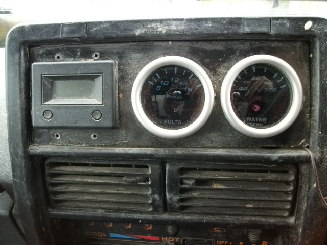

Mudinstructor also sorted my out a collection of bits and bobs... among which I found a dash gauge panel!
It fits over the cubbyhole next to the samurai clock. In itI have put a water temp (super important ;) ) and a voltage gauge.

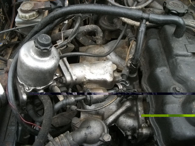

SU Carb
This is probably the best mod I have done to the Samurai so far!!!
When I got the SJ it had a standard aisin carb on it which, rather predictably, broke.
The auto choke broke so it was doing the usual idle at 3000rpm, either that or cutting out when you take your foot off the pedal!
Pain in the arse!
So I thought it would be a good investment to get an SU carb (after reading A LOT about the carbs themselves, and about the conversion). I bought my SU from ebay... some guy had just ultrasonically cleaned it and rebuilt it... I got it for £53 :D
I had already decided that carb adapters are rubbish, and went to Rhino ray for one of his adapted manifolds... cost £120 + my old manifold, but by god is it worth it!!!! It now works perfectly, all the time! :D
(Except when I drowned it in slindon)
To show how good the carb is, it ran my engine on 3 cylinders for about 6 months.... and I was still using it as my daily drive to work ;)

twiss wrote:Back from lunch now... :D
looks like the bit of pipe that goes from the airbox to near the exhaust manifold ;)
oh and good right up too :rockin:
Re: Twiss' Build/Breakages Thread!
Post by twiss » Thu Apr 14, 2011 4:50 pm
Close, but no!!!
It goes out of the airbox and up the inside of the drivers side wing :P
No prize for you :lol:
