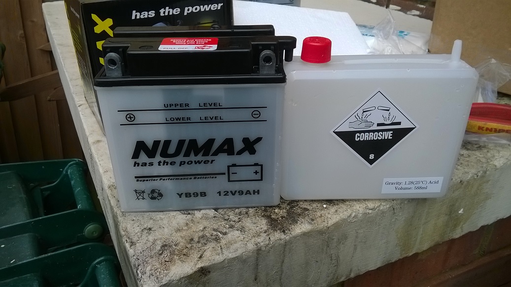

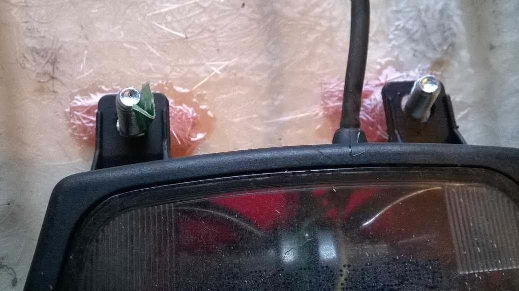

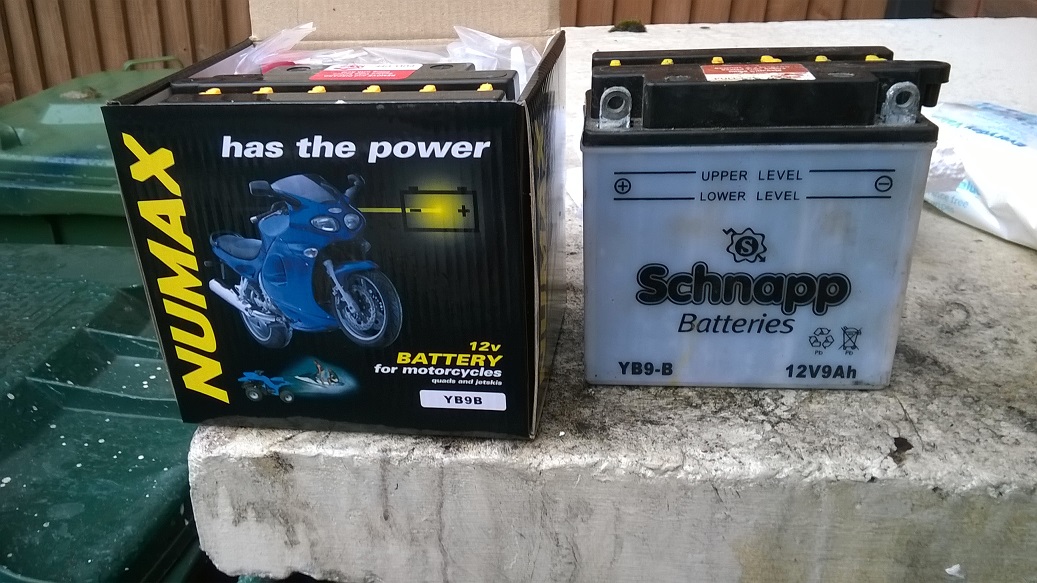

The Mito's battery arrived and it involved filling it with acid. I followed the instructions but I should have done it my way. After emptying the acid bottle 2 chambers were empty. So I sucked some out of the others and did it my way (cue Sid Vicious/Frank Sinatra). So on a charge overnight to give it some serious wallop. And to fit the race seat I had to fix two bolts to the seat itself. So a bit of fibreglass to hold them in place should do it. Meanwhile 'lil Kawazonkey is moving on, more bits bolted on and a new brake lever is on it's way from the US. I can't cut down the one I have as it just won't fit at all.oh and some bits for the race bike arrived. I need rearsets but they are £210 new. Won a set tonight on fleabay for £51!

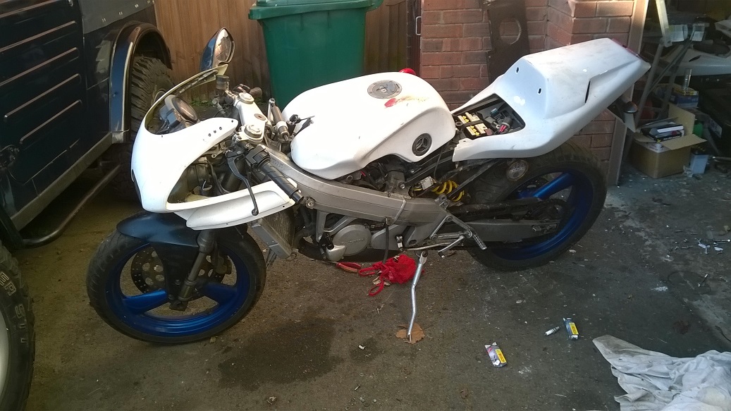

Post by donkeychomp » Fri Feb 06, 2015 9:26 pm
The fibreglass idea worked a treat and the race seat is on Mia. With the new battery on she still wouldn't fire. I then realised I had put the new fuel filter on backwards. DOH! Runs sweet now, but the exhaust is blowing...a lot. Some idiot has welded it up and that isn't a good idea on a 2 stroke as the bore inside the expansion pipe has to be smooth to help exhaust flow and I bet it ain't like that anymore. Might have to get a new one...or maybe not if a 350 lump turns up.
