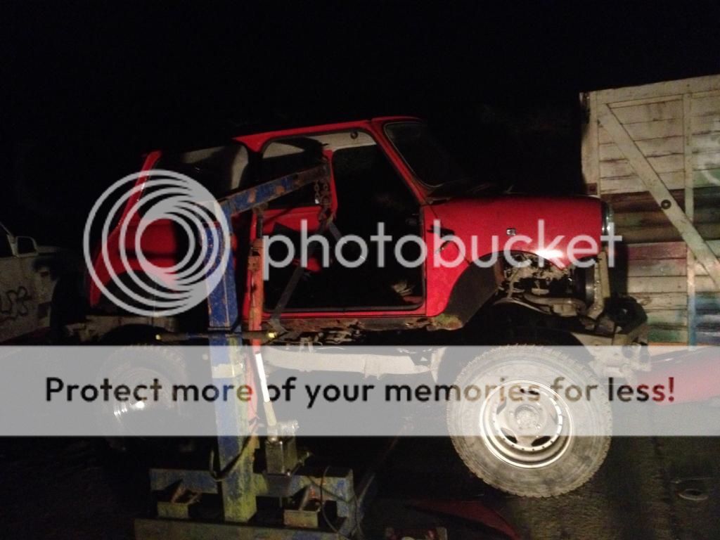

got a bit of an update on the project.
got the z bar for the steering made up and fitted the new waterpump so its no longer dumping all its water out.
we have also removed the old body
and now you will see what this project is going to be and why it is unusual
its not sat right in these pictures and still needs quite a lot of alterations before i will be happy with the way its sitting.
floorpan/bulkhead being cut out
lifting the body into place
transmission tunnel/bulkhead cut out in place
and how its sitting now
still need to drop the body shell down about 100mm before i will be happy with how it sits on the chassis but the project is well under way now

Not too unusual. Saw one years ago at truckfest. Zuk chassis, mini top, 3.5 V8 inside. I'll try and dig the photos out.
Re: sj 413 unusual project
unusual doesnt mean unique
there is actually a website dedicated to 4x4 classic minis on suzuki chassis but it not a normal thing to do.
and yes half the engine is in the footwells

Scottie from HPOC's son had a 410 with a mini body on it. Scottie helped him work on it, although I don't think they did the actual body swap, just bought it as an unfinished project, got it going, MOT'd it and sold it on.
Anyhow, definately a project I'll be watching.
BTW - what're you doing with the old body?
once we have taken what we want off it we will scrap it
its not going to be put on the road,at least it wont be yet.its going to be an off road plaything
