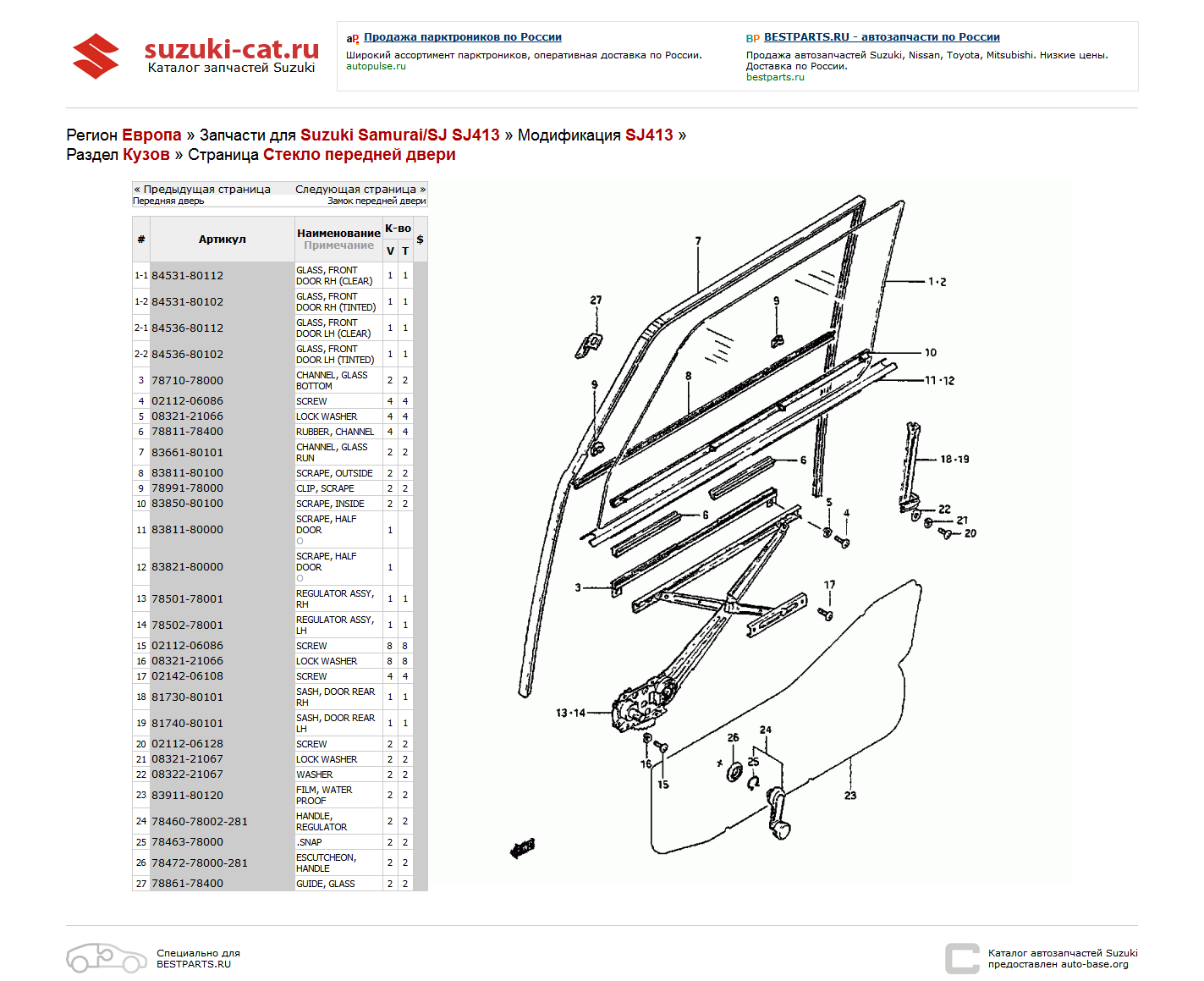

A long shot I know but does anyone have one of the little channel things that holds the glass onto the regulator? I need one for the passenger door.

I don't have any spares , but may help identify which bit your after.
SJ413 Body 85 (45).png (151.04 KiB) Viewed 8823 times

Thanks Darrell. The winner is item 3 channel glass bottom. If anyone has one before I get golf of the main stealer.....
