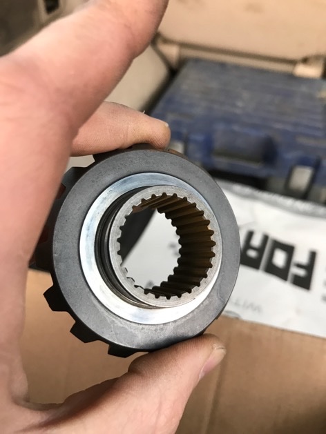

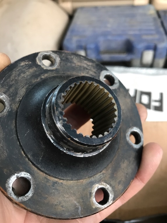

Right so rear axle, need boggers shafts, limited by space and parameters I have. So I went and bought a j33p £206 ! Then took a diff out, so machine shop could copy the spline design and machine suzuki diff side gear and drive flange to the same spec, then have yet more custom shafts made, bore out the spindles fit it job done, also going to either dowl the drive flanges, or double bolt them.

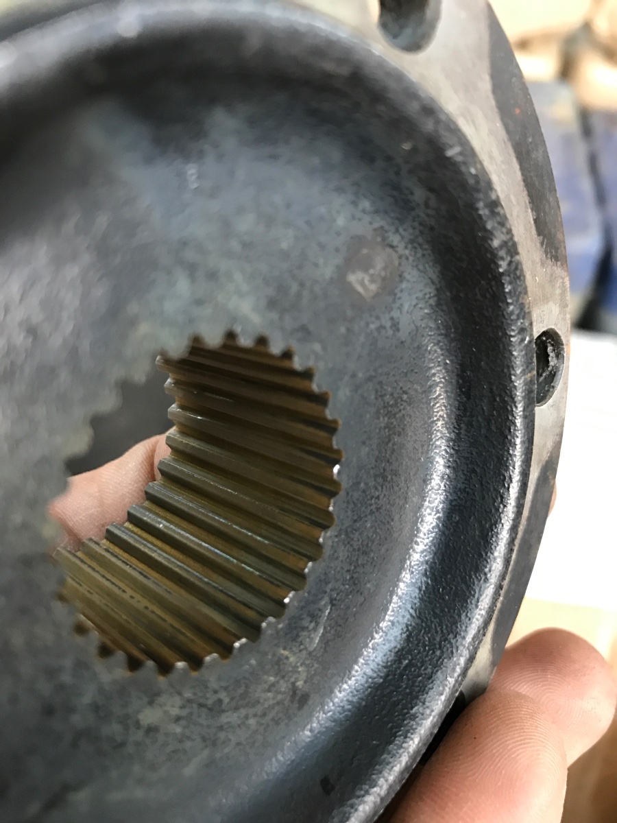

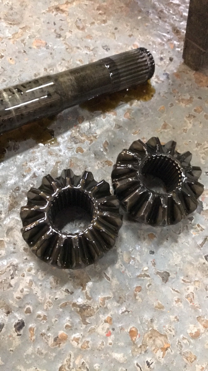

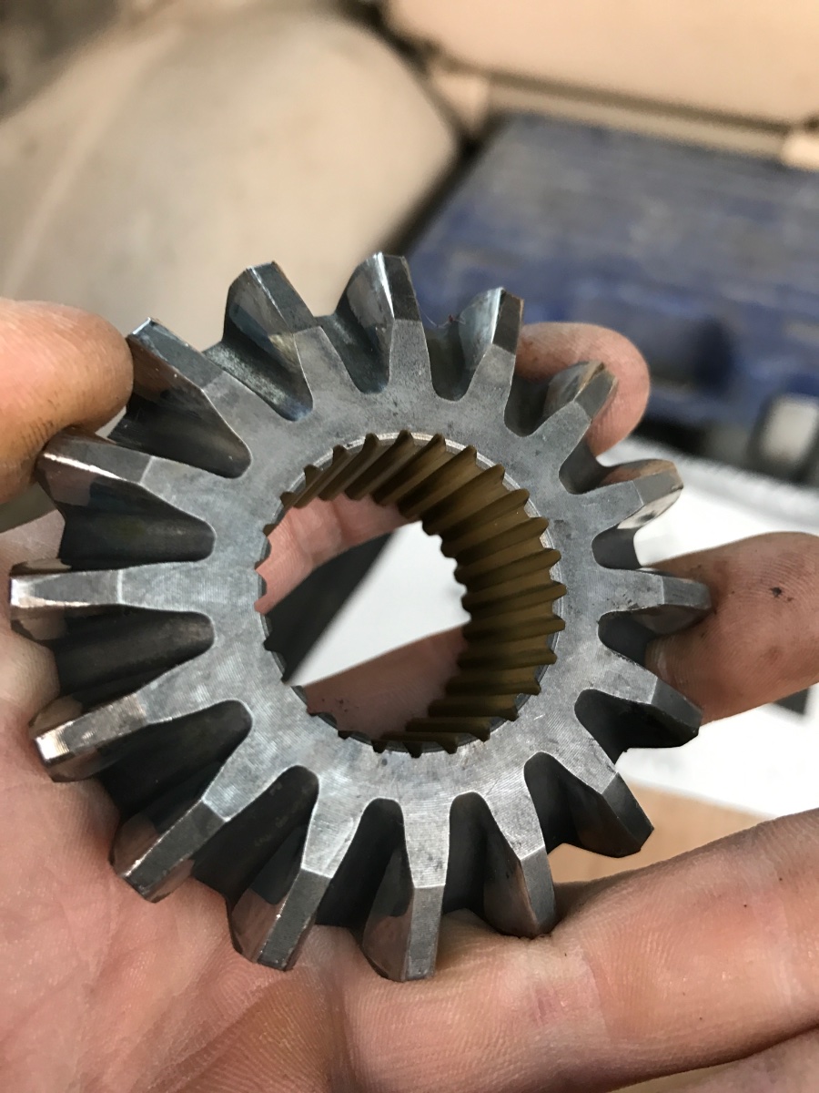

So sent them bits to machine shop to be shadow graphed
Basicly measured then transferred into wire erosion machine
Flange and diff side gear machined out and this is the result

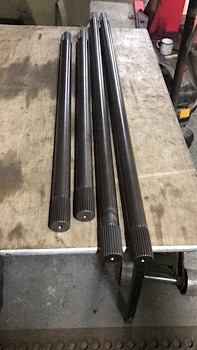

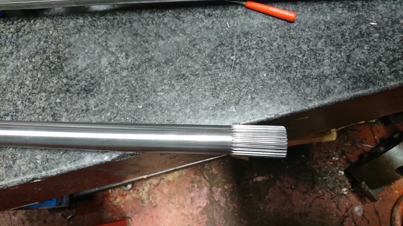

One shafts been done
Now waiting for three more then heat treating

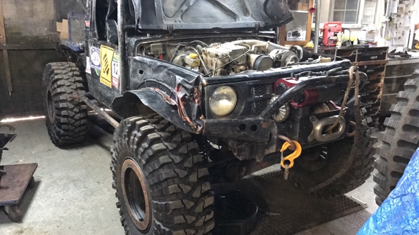

I got lots to do now trucks got tired like me ! Haha
To do list
New batteries winch ones are fried
Now has no brake? Need to fix that
Hard to select gear (clutch is now over 10 years old) needs new one
Change diff ratio to 3.9 and build spare for events
100% rebuild of axles, I'm going to take them off for a change, clean the crap and metal out of the inside ect
Have the spindles for rear axle bored out for new shafts to fit through, also have the flanges dowled and the flange bolts increased to 1/2 inch
To do list

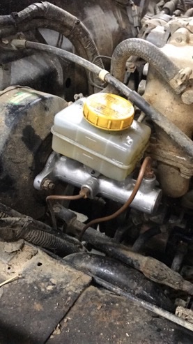

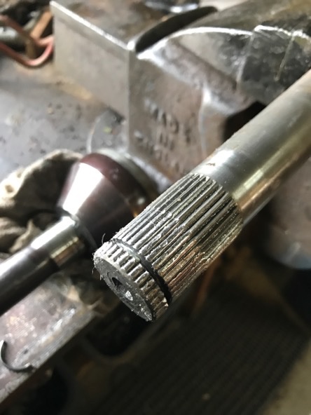

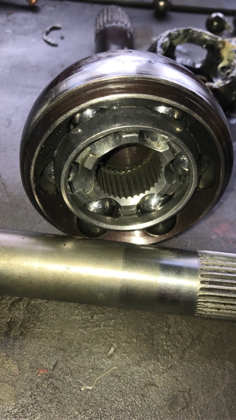

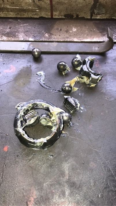

So exploded an rcv ultimate front cv, blew the inner apart and has damaged the shaft. They sent me rebuild kit for the cvs so I built both of them up, these are my spare set so the new ones are in the car now.
Subaru Impreza master cylinder let go as well so fitted a new one.
Waiting for my 27 spline side gears to come back then I can build up the rear diff

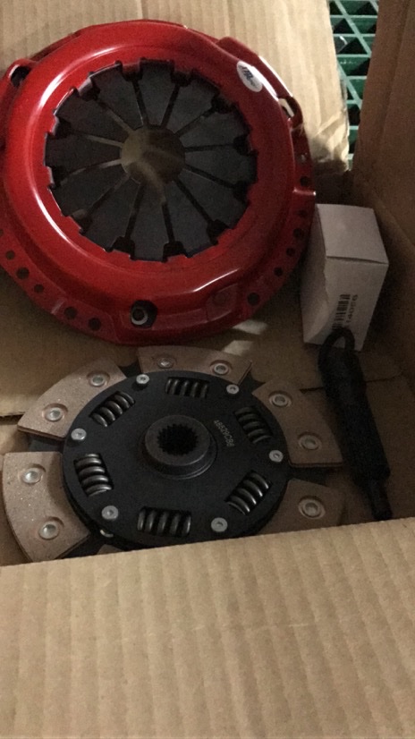

Fitting two numax batteries for the 24 volt winches on Monday and going to replace the clutch, the paddle one in there been good for 10 years ! Think it's now worth swapping before it lets me down.

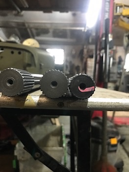

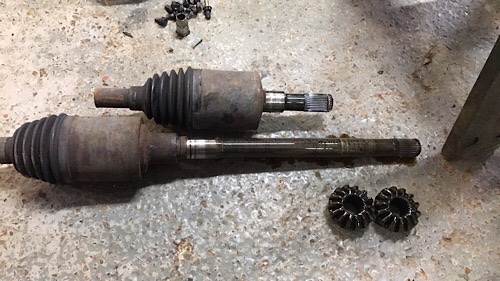

Shafts ended up being a nightmare with rcv they where lost empty box delivered to me lol all sorted now have an extra extra pair of spare front shafts

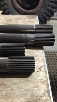

Tears are now done and here you can see the size difference.
No just to bolt it all up, machine the spindle out a bit, fit the new paddle clutch
And hopefully go get muddy !
