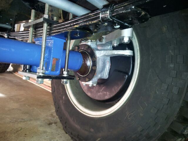

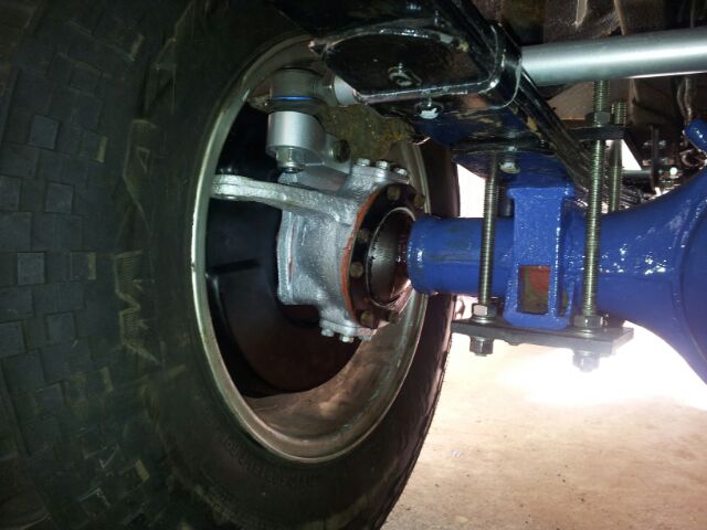

Thanks I have rebuild kits for both sides as the swivel seals are leaking and kingpin bearings showing some wear so I will strip everything down and paint e, t, c . Thats my next job along with the exhaust
gp7186
Posts: 112
Re: 1991 Suzuki Samurai build
Post by gp7186 » Mon Nov 04, 2013 3:05 pm
Managed to get both sides rebuilt with new wheel bearings, half shaft seals, kingpin bearings and swivel seals also cleaned and sprayed everything up
