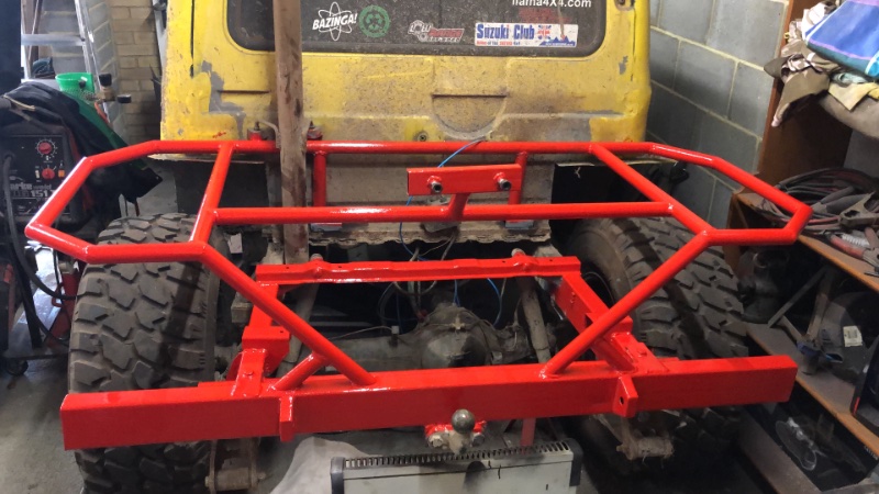

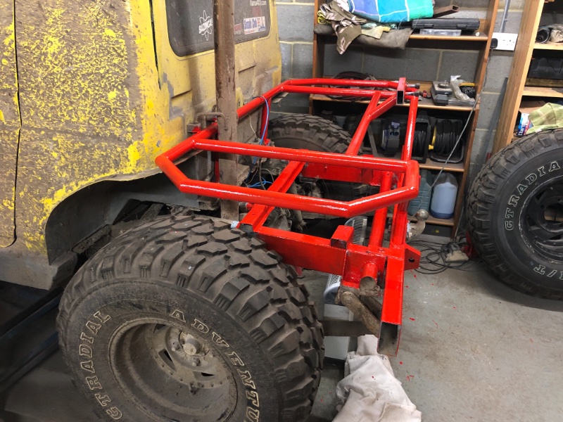

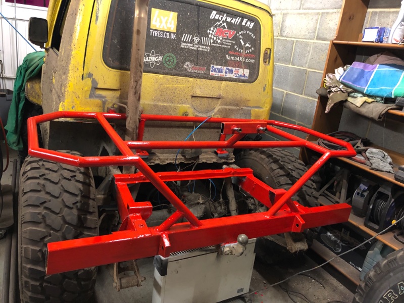

How strong are the rear wings, can they be stood on? Looking like you'll be back on the road in no time!
- Jordi
- Posts: 7540
Seem strong enough to stand on, need to get a big lad to stand / bounce on them for a better test. I’ve been climbing all over it and it all seems solid, the little triangle braces on the back bumper stiffened it right up.timwilks13 wrote: ↑Mon Jan 21, 2019 12:07 amHow strong are the rear wings, can they be stood on? Looking like you'll be back on the road in no time!
Another coat of primer, couple of coats of colour. Fit the lights.
Got plenty of SCUK shit rubber to add as spatz to bits of it.
Trying to find some smaller gauge waffle board material for the in-fills on it.

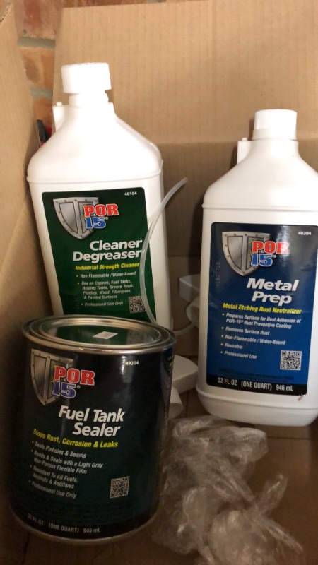

This also arrived to clean and line the inside of the fuel tank. It is fuel tight this is just another precaution and to prevent it rusting from the inside out.
The additional fuel pipe and fittings have arrived along with new extra long brake flexis for the back axle to run straight from a t piece to the caliper instead of having copper lines running along the axle.
- donkeychomp
- Posts: 3582
- Location: Shepperton, Middx
POR is really good stuff Jordi used it on bike tanks but the inside of the tank has to be bone dry. Use a hair dryer or something!

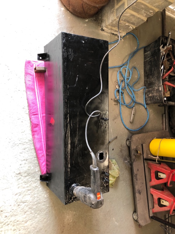

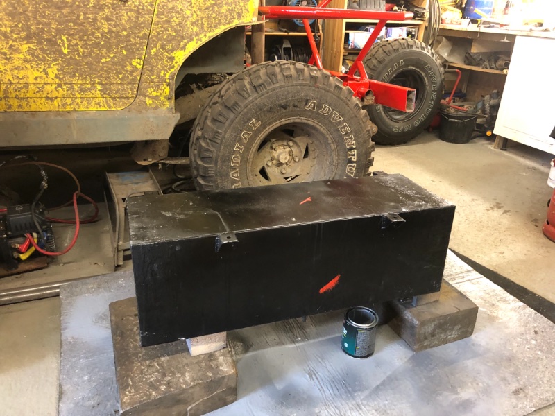

So it’s been washed out, rinsed out, metal prep’d, rinsed out, dried thouroughly, liner poured in, swilled round, sat on each side again, swilled round and is now draining the excess.
Despite reading up on this POR 15 stuff, took a lot longer than expected.
Also going to paint it red.
