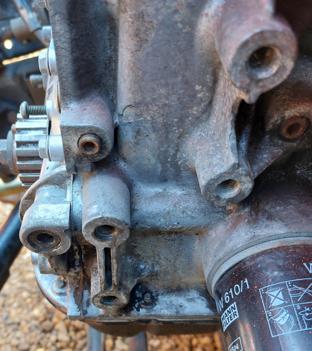

I am examining power steering in great detail now. Have collected some parts together. Fixing bracket to engine block is not correct.
Sorry seems like I might have misled you on the Jimny G13 bracket. I have previously been told they fit but it looks like they added an extra mounting position on the Jimny G13 block, I always bin the 1.3 for a 1.6 so have never noticed that.
The vitara g16 brackets fit but the clearance to the chassis rail is tight. There are kits available from HM4x4 that come with an aftermarket mount and the crank pulley to match.

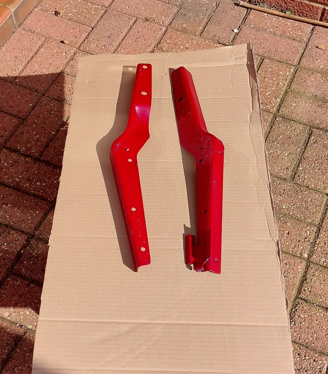

Been doing some cleaning up, rustproofing of radiator supports.
Am able to get a clear view of area where power steering would go, whether hydraulic or electric system.

Some paint on the radiator supports.

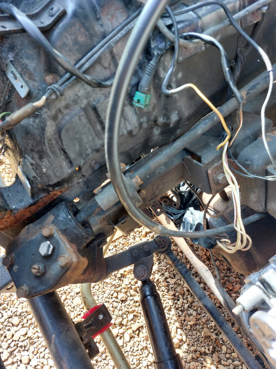

View onto steering box area.
Alternator wiring will require modification as have upgraded alternator spec:
View onto power steering bracket area.
PO altered wiring to oil pressure switch. Not very happy with it.

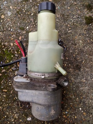

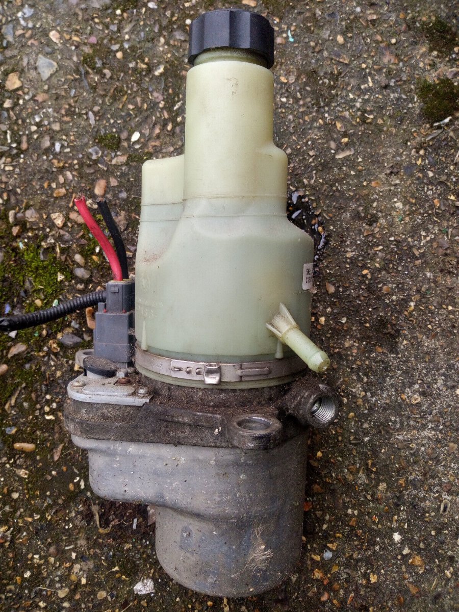

My research into power steering led me to look at the "electric hydraulic" system fitted to various models of Volvo.
Video on Youtube of one fitted to a LHD Samurai.
What else does one do when it is pouring with rain!!
Interesting set up that I shall look at further and report back.

Post by ScottieJ » Thu Mar 28, 2024 7:28 pm
My experience of the electric hydraulic pumps when combined with the Jimny steering box is that it’s usually quite rubbish and the steering is still heavy, people used to use the PSA units.
I would just fit a suzuki based, engine driven pump using a kit. It’s a simple and reliable set up that’s proven to work.

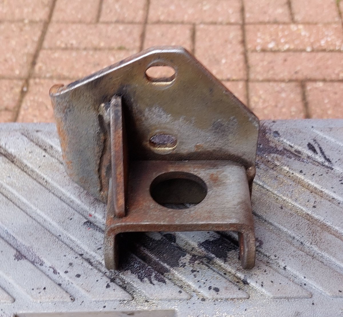

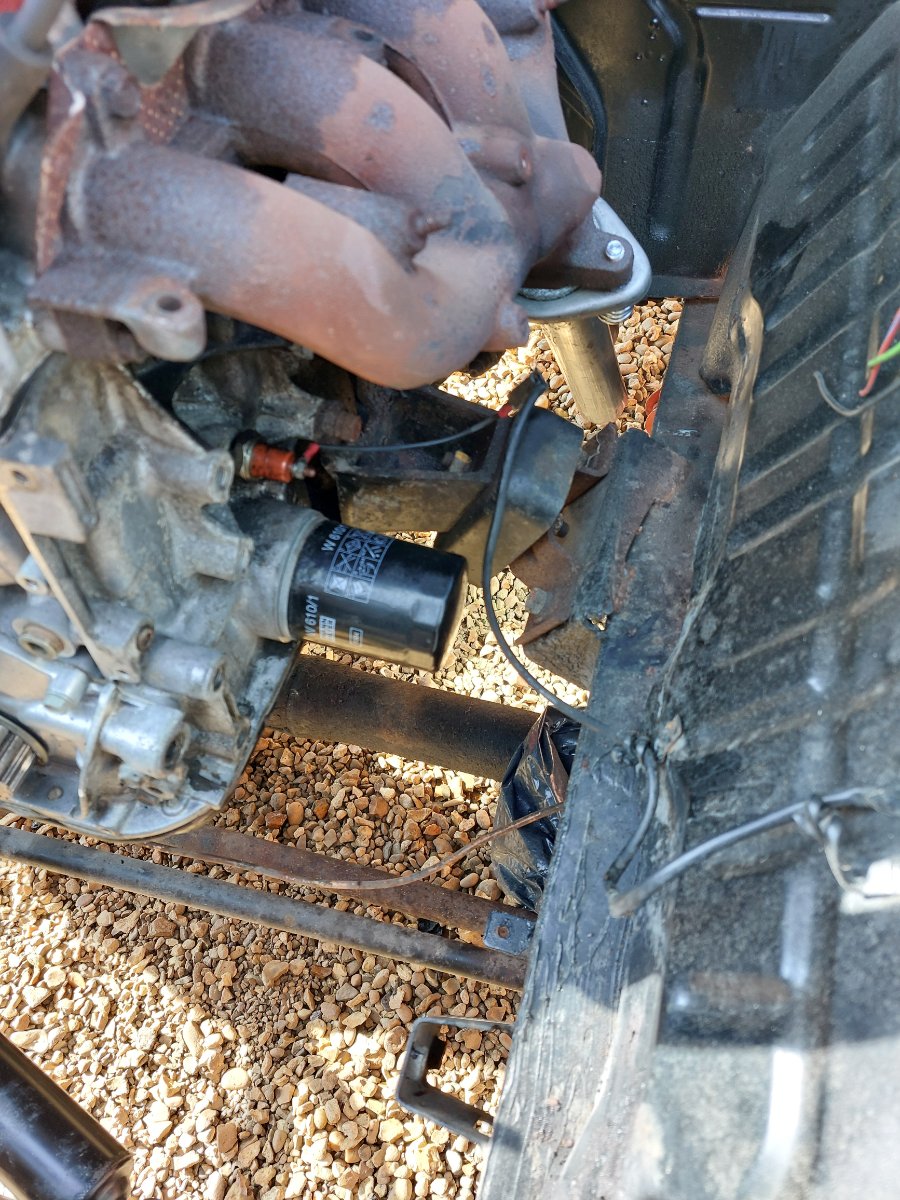

My woes regarding finding a fixing bracket for a power steering pump continues!!
Am now thinking of measuring up and having one fabricated.
Fixing arrangement as shown in picture.
