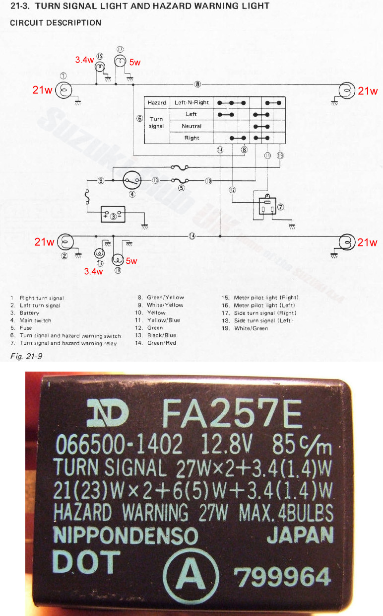

Re the indicators, Check the bulbs and make sure they are the correct wattage, you can get different wattage bulbs for different applications, if they are too low a wattage they will flash too quick, what are the wattages? I don't know, I'd have thought Darrell might know, he's the resident SCUK librarian

As tramp said, when I didn't have any side indicators I just put a higher wattage bulb in to stop them flashing too fast :)

Post by Darrell » Fri Mar 28, 2014 8:05 pm
This is my SJ413 (Jap - 1987)
