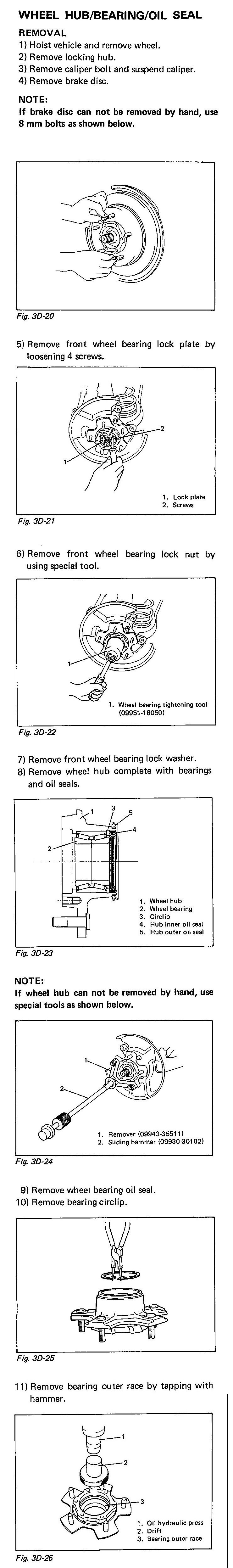

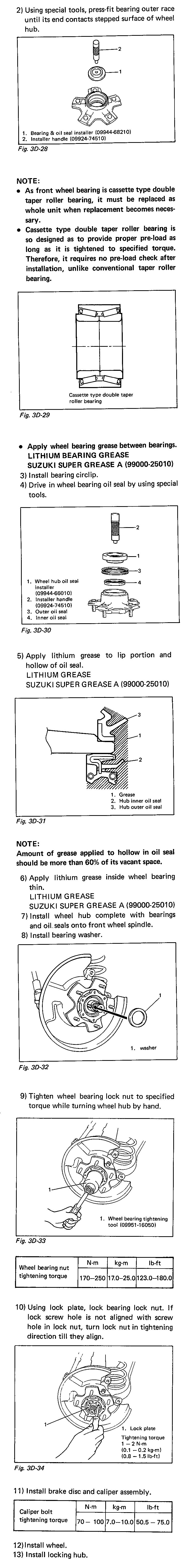

Post by Darrell » Mon Apr 07, 2014 8:26 pm
Had a shifty through the manual and it could be blooming tight.
Robbed the relevant sections and pasted together :thumbup:
vit wheel bearing instalation.jpg (745.36 KiB) Viewed 6701 times
Vit wheel bearing removal.jpg (502.88 KiB) Viewed 6701 times

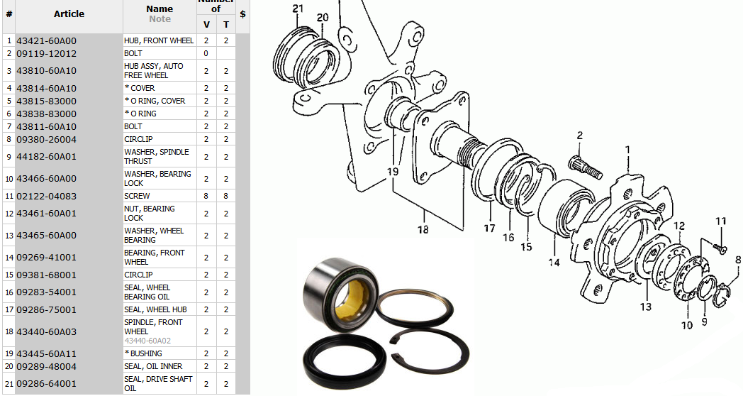

Re: wheel bearing.
Post by Darrell » Mon Apr 07, 2014 8:33 pm
285cupramatty wrote:Ok well I see the tool on bits for vits and its £42 bit more than I want to pay. I have an idea for a make shift tool. Hopefully should do the trick I've found the wheel bearings at gsf.
Thanks for the replies
Good price with all those seals :thumbup:
http://www.gsfcarparts.com/413sz0101
