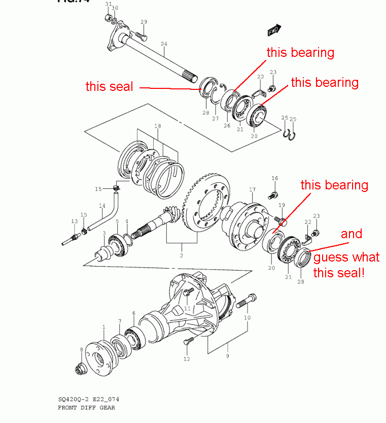

Well you've just about talked me into getting some for my GV.
Won't save sod all much fuel, however you wont be wearing out these!!!!!!!!!!
Well just the CV's a little on suspension movement...

Re: Grand Vitara free wheeling hubs, do they help in any way
So they can save a fair bit of wear and tear then?
