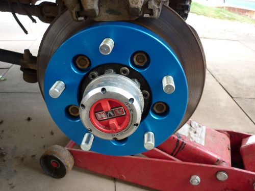

Post by Darrell » Tue Aug 05, 2014 8:56 pm

kiwizook
Location: Masterton, NZ
Re: wheel adapters
Post by kiwizook » Wed Aug 06, 2014 7:48 am
what's the brand of those fwh's in darell's picture? I have a set of those on my wagon, but I need a bunch of new screws for it, and they are a really oddball size, so I'll probably have to order them from the manufacturer

Post by timwilks13 » Wed Aug 06, 2014 8:56 am
Looking at the picture im inclined to think its these guys? http://www.avm.com.br/products4.htm

Post by Rhinoman » Wed Aug 06, 2014 9:39 pm
Those AVMs have been copied by the Chinese, there are a lot of cheap copies about.
