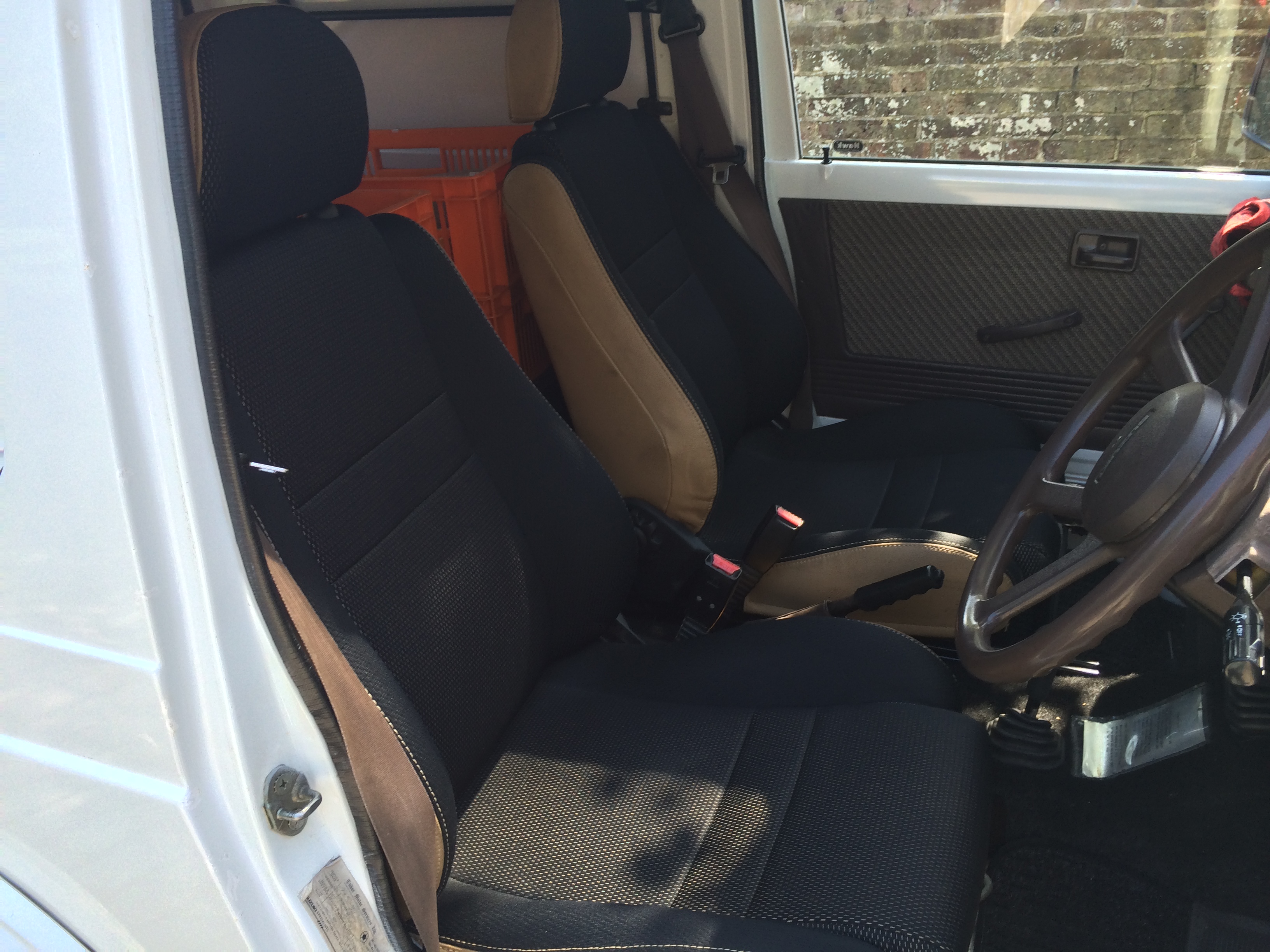

I like the sound of this build, what about a pair of swift sport or ignis sport seats?

Thanks all, I shall consider and investigate alternative seats. I do plan to keep and restore the originals anyway, partly because I get the impression that hardly any SJs still have their originals. But if I send them for retrim I'll need seats in the meantime and they ought to be Suzuki ones.

Saw molehill's seats the other day... MG TF seats I believe!
They actually make the brown dashboard look acceptable!!!
