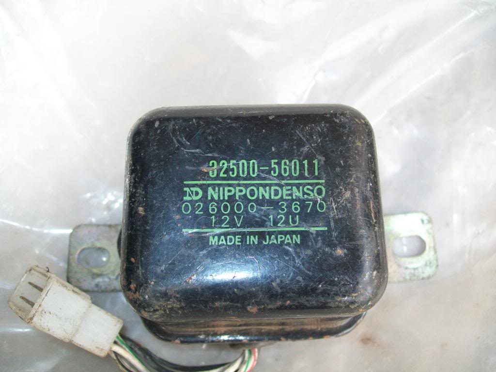

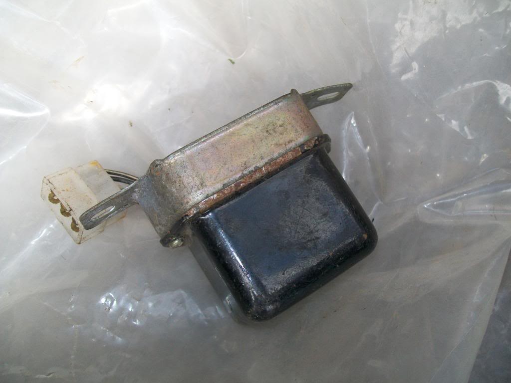

Post by Darrell » Sun Aug 17, 2014 8:40 pm
What year is yours as I think they are only fitted to 82-83 models.
If is has one it looks like this.
kiwizook
Location: Masterton, NZ
Re: sj410 alternator issues
Post by kiwizook » Mon Aug 18, 2014 7:11 am
gotcha. mine is a '84, and it has a box that looks like that one, with the mark "new era" on it. that should sort it I would say
