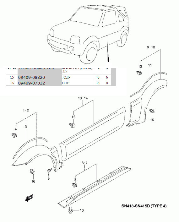

Hi guys,
the side skirt on the jimny has come off. A friend stepped on it while getting out and it has obviously fallen off before and replaced with dodgy panel pins.
I now have a small problem of finding a set of the correct plastic trim panel pins to attach it back. I tried a few I had but nothing was suitable.
Any ideas what the actual pins are called?
Any help would be greatly appreciated!
Thanks all.

Trim clips, they are about £4 each!
I've replaced mine with self tapping screws!

Give number 16 a Google.
Readily available on fleabay and cheap.

Post by mmac78 » Mon Apr 25, 2016 10:56 pm
I tried 16 (part number 09409-07332), they are push pins. They attach the skirt on the underneath. The clips that push into the trim & sill are different from those. I think I may have the right one, found 10 on ebay & with some luck might work!
Will keep the thread updated as to how I do :)
