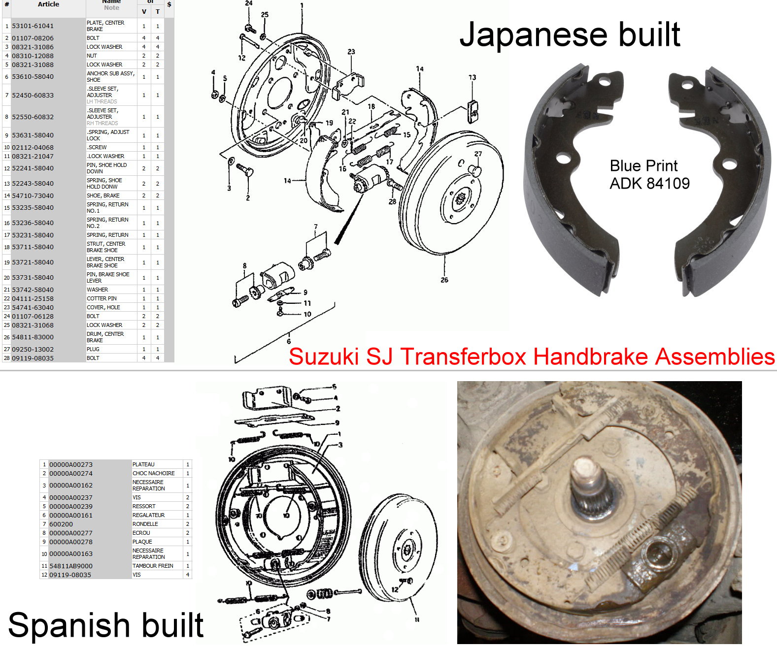

Hi guys, looking for someone to save me.. Got my finished zuk finally finished 1.6 in it painted lift kit big wheels, put it in for mot and it has failed on one thing!!? The hand brake adjuster in the tranny box it seized and is not use now tried to fix... Does anyone know where I can get one of these or any second hand ones about...Desperate!!

Neither, it sits in the hand brake drum between the brake shoes.. I think it's an unusual set up most sj's are not like this

Is it this part ?????

That's the one but that is the jap version i meet the Spanish
Suzuki SJ transferbox handbrake assemblies.jpg (414.2 KiB) Viewed 9776 times

Thanks for the picture and trying anyway! Anyone els that might have one or know where I could get one I would be forever greatful!! Keeping me off the road at the moment as the truck is to be my daily driver

I believe the whole Spanish handbrake assembly can be replaced with the Jap one, I can't confirm this though.

So you think you could just swap the whole drum and everything inside? The actual hand break wire would be the same?
