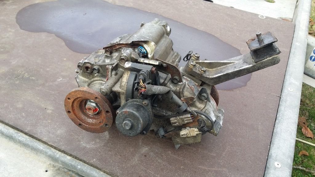

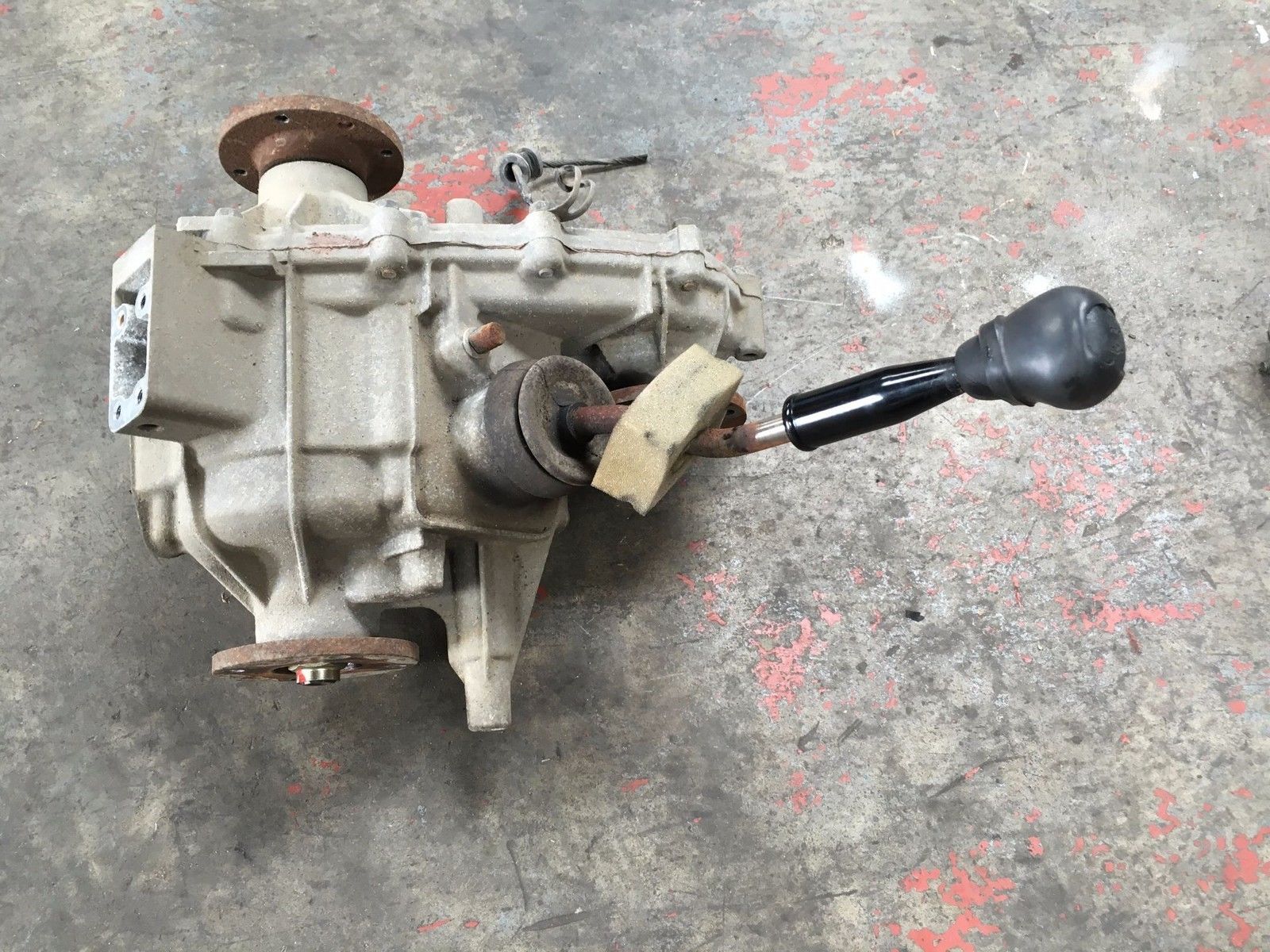

Re: Electronic transfer case problems...
Well i've just had a search and I don't think you will be able to convert it to manual, It's quite a bit different to the earlier type.
- $_86.JPG (107.46 KiB) Viewed 12546 times
- 2002-Suzuki-Jimny-Manual-4wd-transfer-box-_57.jpg (398.8 KiB) Viewed 12546 times
