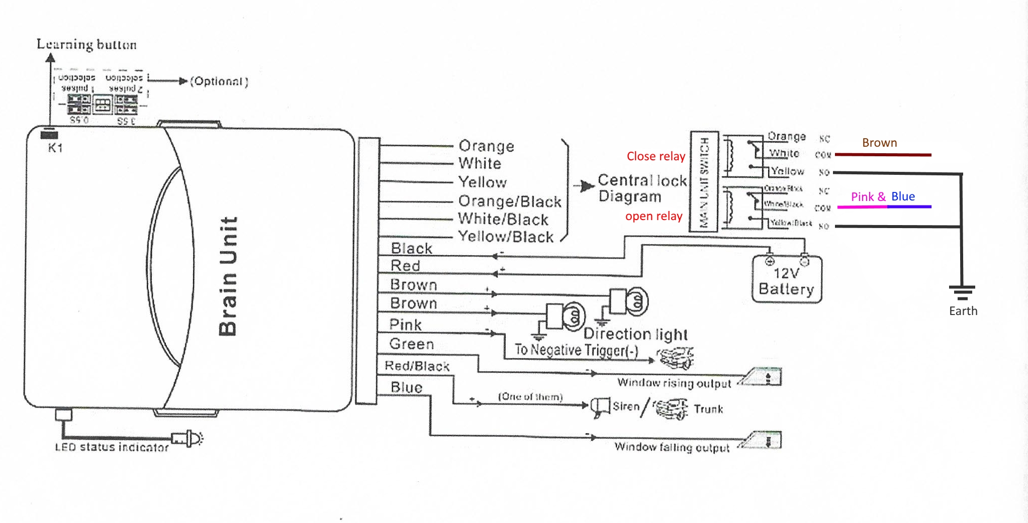

I have already got central locking on my 2002 Suzuki Carry Van. I have bought a conversion kit to make it remote, but I am not sure on the wiring.
2017-02-21_181227.pngsusuki doors.png (51.04 KiB) Viewed 7814 times

Welcome to the forum. I assume its just the 6 wires to the central locking your not sure of. Me neither !! I personally don't believe its any of those 6 diagrams shown. I think it's printed wrong, figure C negative triggers is correct but they way they show it a live would just short to earth.
The drivers door key switch shows it in the middle position at rest and earths either wire dependant on open/close.
I can do a diagram of what I believe to be correct but would like second opinions.
Re: remote control
Post by Darrell » Tue Feb 21, 2017 11:22 pm
How I think it should be ;), this is very dependant on the key switch not connecting either the brown or pink/blue to earth when the key is removed.
Opinions more than welcome :thumbup:

The first diagram is from the Suzuki Carry .
Re: remote control
Post by Darrell » Wed Feb 22, 2017 9:11 pm
Suzuki diagram is fine, it's that last diagram - top right (as you read it) - I don't trust.

Post by Radar » Mon Feb 27, 2017 7:54 pm
Thanks Darell.
Works fine now.
