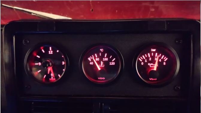

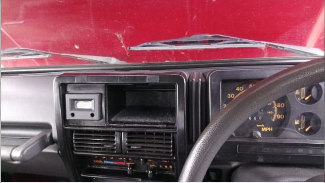

Gave up on trying to make the temp gauge work and did this instead to go along with the OP gauge and clock I had been wanting to fit.

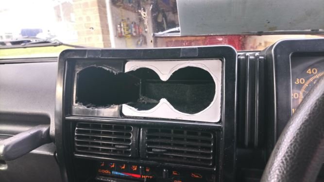

Broken LCD clock has to go .

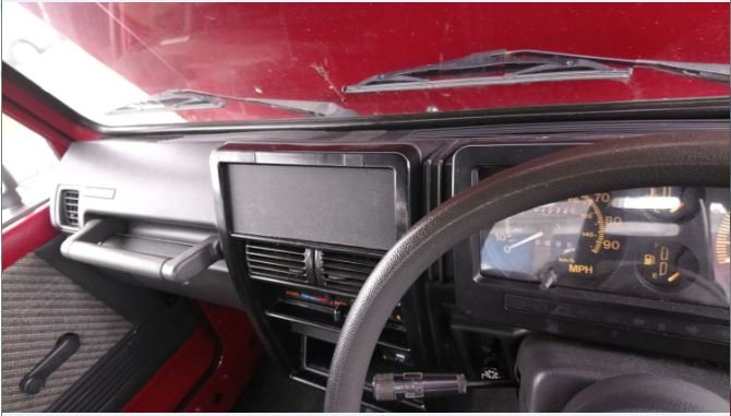

Make a  blanking plate.

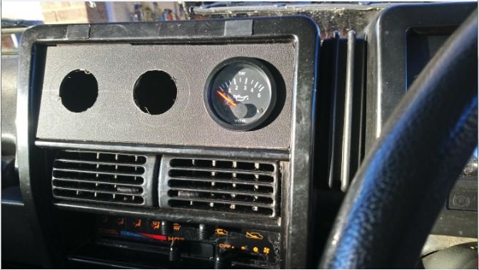

Find the centres.
Find the centres.

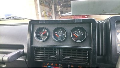

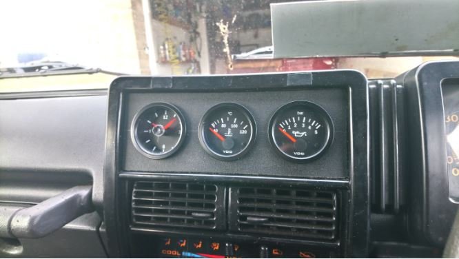

Fit the gauges and wire them up.

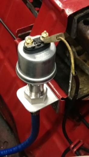

Remote OP switch to get around the BSPT - NPT issue.
The temp sits about 82 when warmed up.

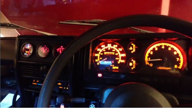

150ohm resistor fitted to stock gauge to make it read.

Post by Anton » Mon Mar 26, 2018 12:34 am
Very nice!
Re: Temp sender reading too high
Post by Jordi » Mon Mar 26, 2018 11:51 am
Nice tidy job on the gauges.
