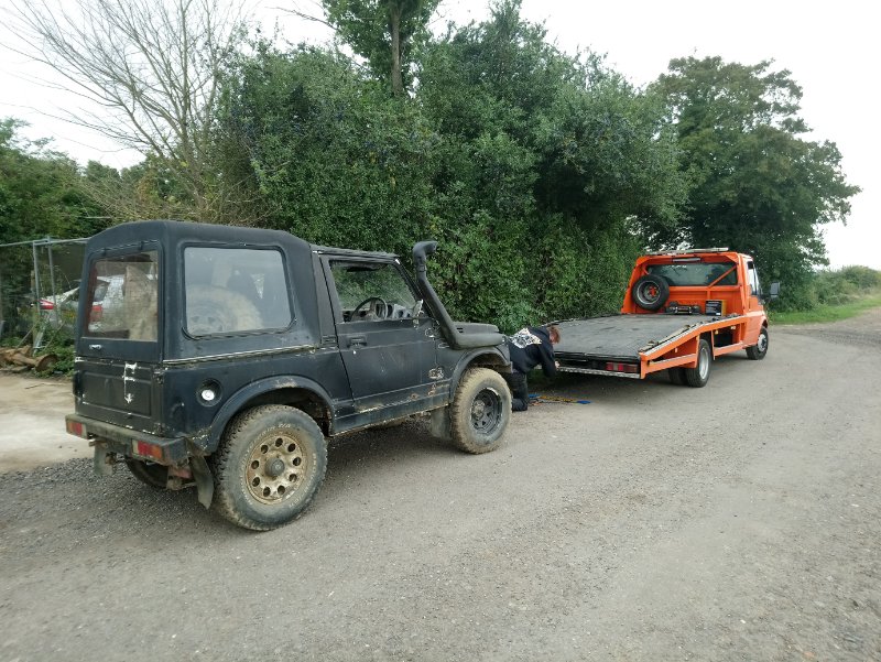

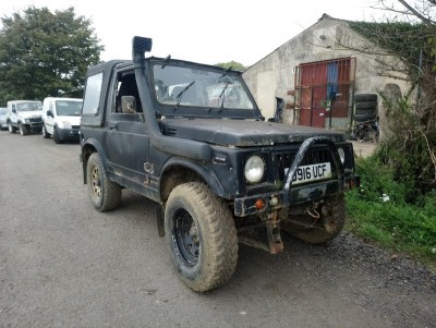

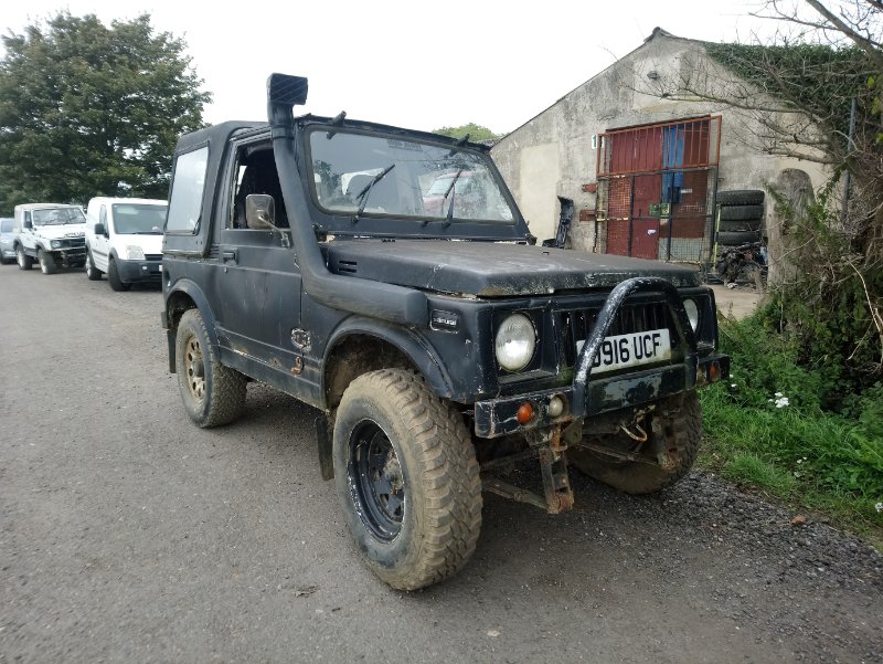

So after writing off my Suzuki Vitara on the road of all places, I decided to buy myself an SJ project for my 21st to make use of the engine and waste yet more of my hard earned cash.
As you can see it's a fairly battered 410 (what SJ isn't). I bought it for £350 with the cost of it being delivered back home - not too bad at all.
I've bought a set of rough country YJ springs and extended shocks, the rest I will worry about after it's road legal again.
I essentially bought the project to learn more about mechanics after tinkering with my quad bike for a few years; a mig welder has already been bought to patch up the areas of rust.

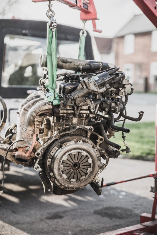

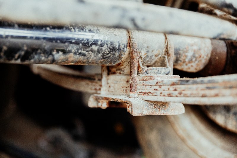

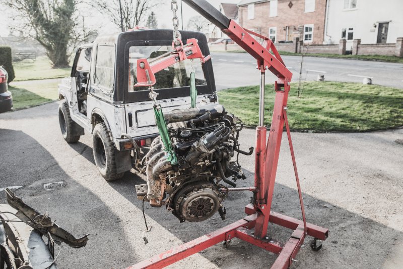

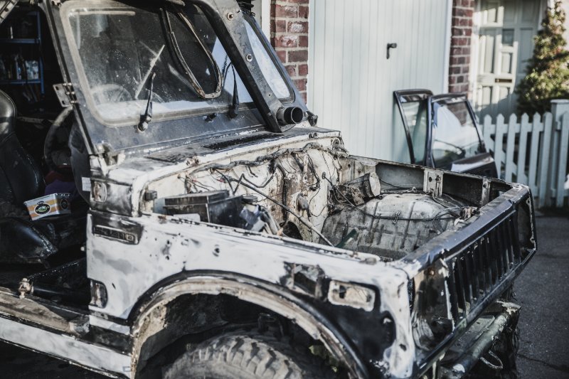

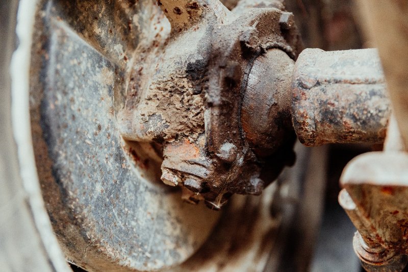

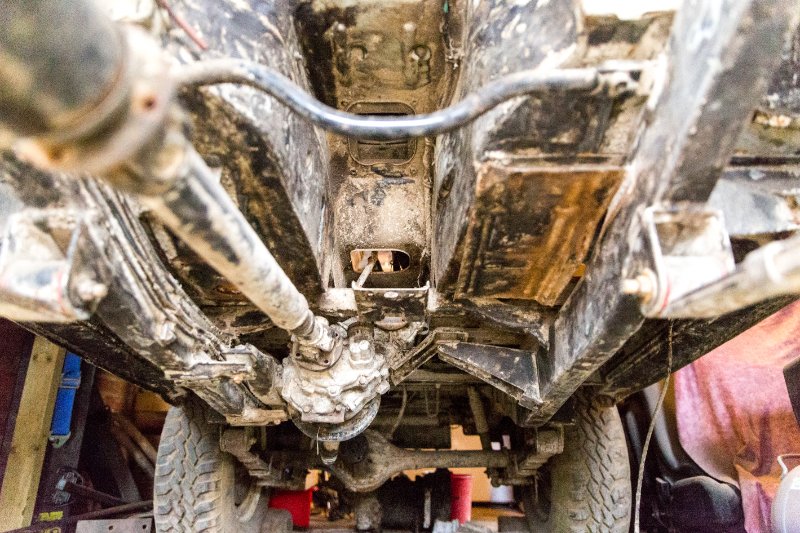

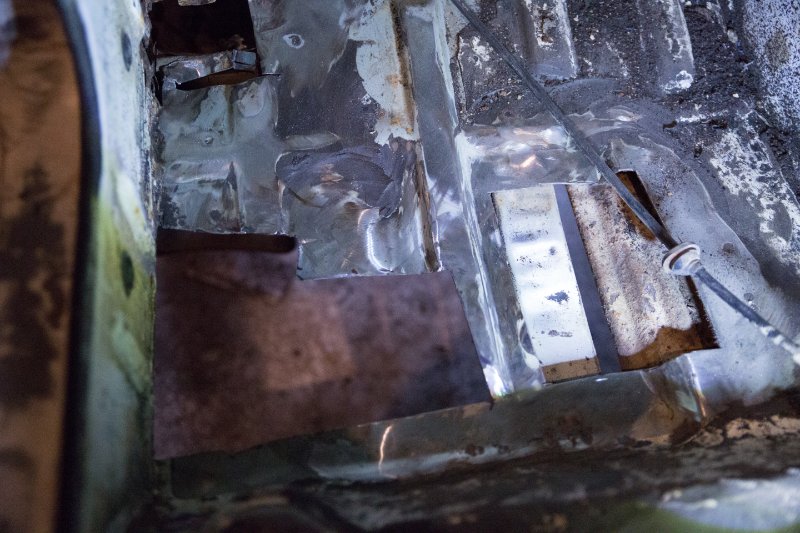

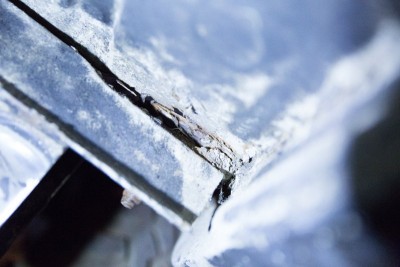

Quick update of photos from the past few months. Made a good start at wire brushing/burring off a lot of the mud that has cemented itself practically everywhere...been a long process so far.
Hard to find an area that isn't caked in crap lol doubt this is an uncommon sight with SJ's.
Also sanded the majority of the paint of to its original colour as you can see from these photos, have to say love it in white but not sure it's worth repainting it white...need something more forgiving on the imperfections...

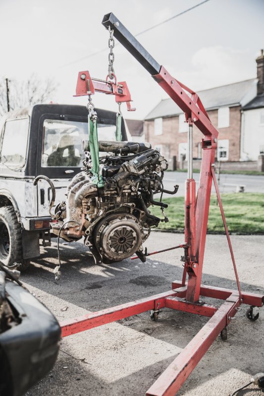

Engine on the crane is a 1.6 8v from my old vitara.

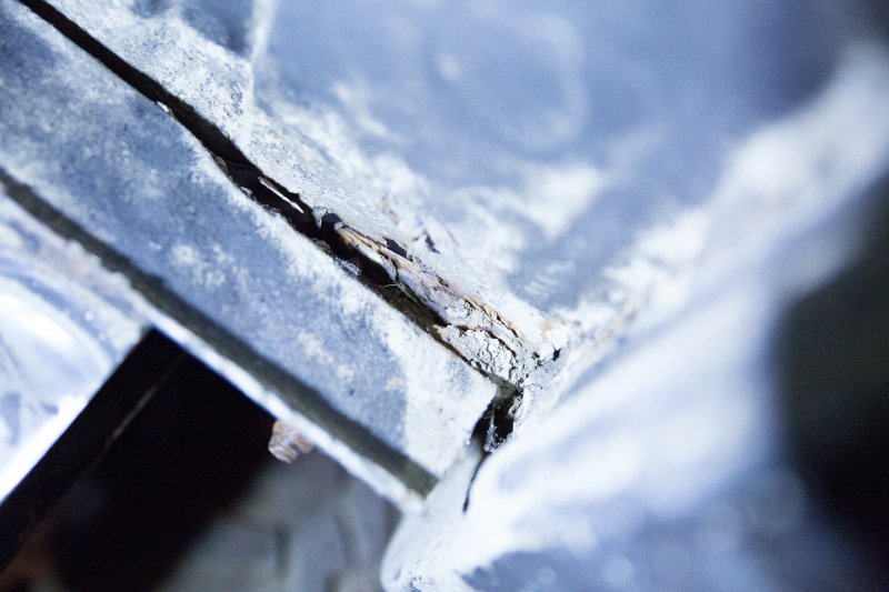

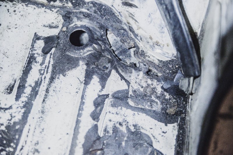

Rest of the photos are a few pictures of areas of rust that I'll be welding up in the next few months, much the same as many I've seen in other threads, arches rotten floor pans over body mounts etc...could take some time as I'm learning on the go :weld:
Seems best to go for a virtual lift as this will solve most of the rust issues around the arches, can't say no to the idea of bigger wheels in the future
