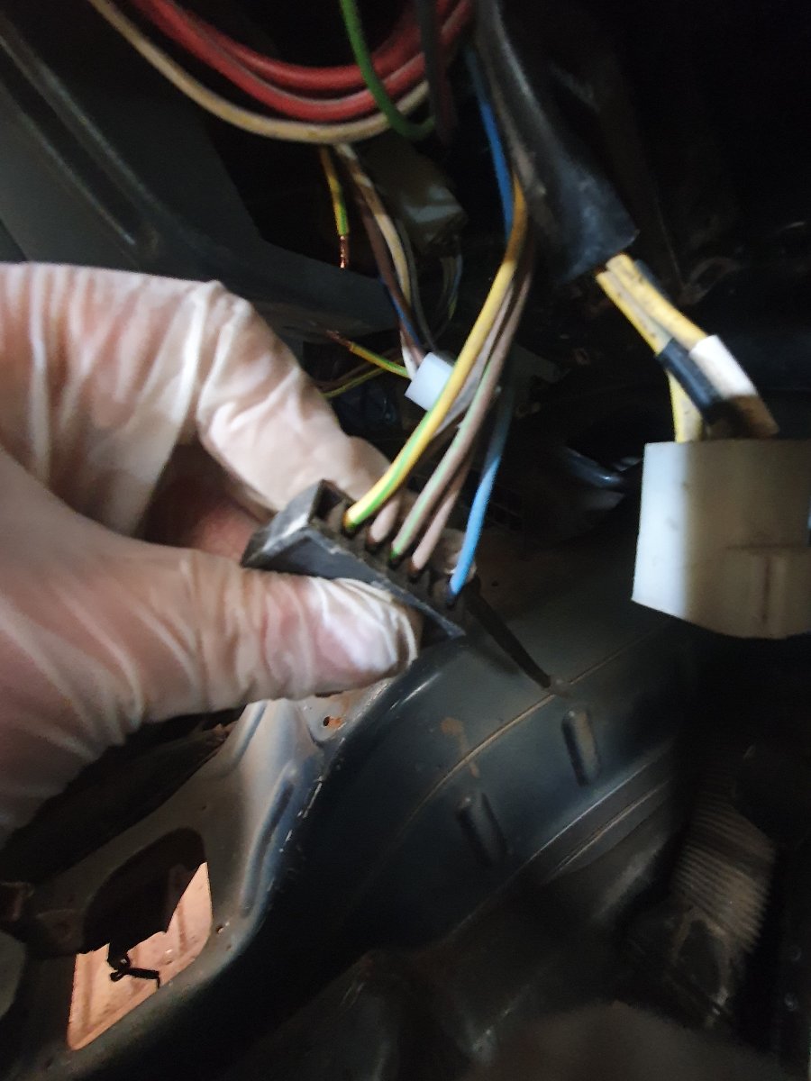

Been putting the dash back into the lwb and I've managed to get most of the connections back in right places, I think 🙃
Don't recognise this one tho
5 wires coming from it and is located just under steering colum but I can't see anywhere it would plug into and I don't have any notes for reference as I didn't remove the dash myself.
Any help would be very appreciated thanks
Re: What Plug is this?
Post by ScottieJ » Tue Nov 07, 2023 9:34 pm
Stalks I think, for the wipers.

Cheers Scottie, I'll have another look around them already put 2 plugs in but couldn't see a third there.

Cheers Scottie that was exactly where its for. I don't suppose you have a non blurry santana samurai wiring diagram? Few wires different places ill need to trace out.

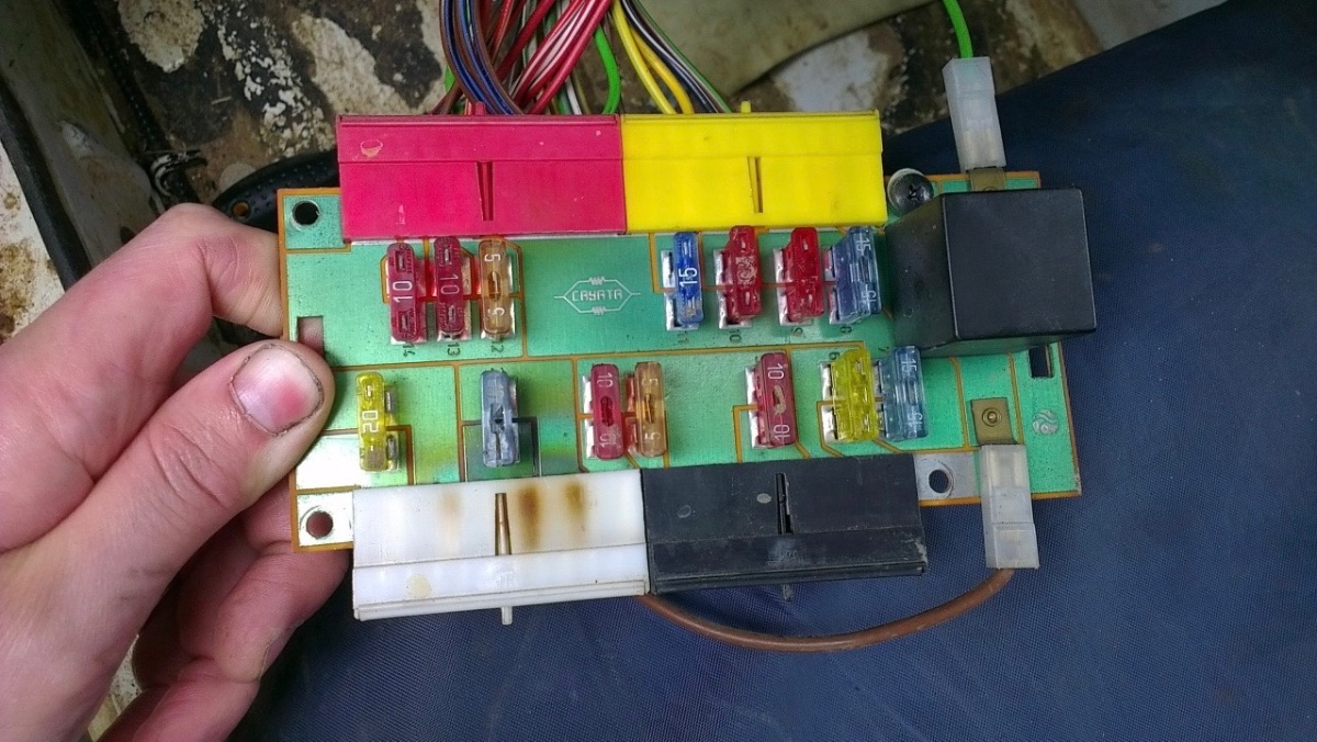

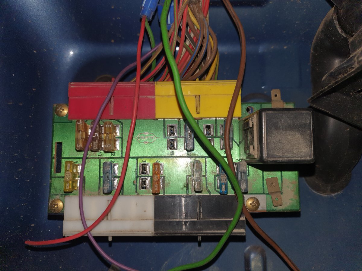

Good chance I'll end up changing the fuse board down the line, some things I'll need to remove as there's a rear wiper loom in there to but I don't have a rear window so probably get rid of it all
Post by ScottieJ » Fri Nov 10, 2023 11:02 am

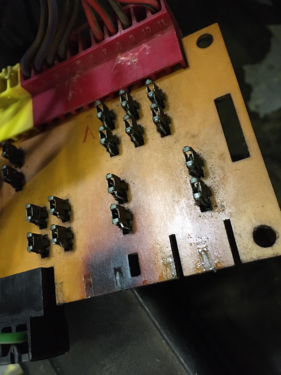

Would 100% recommend ditching the Spanish fuse board.
They are crap 🤣 and they can get a bit hot on certain circuits 🙈
I swapped my LWB over to a Japanese loom.

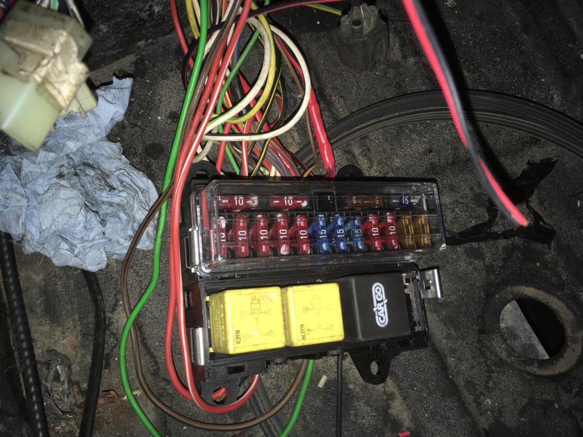

On Adam’s Sj I swapped in some clip together aftermarket fuse and relay holders after the above happened. Dan2k had one almost catch fire on a laning trip in Wales as well a few years back. 😅

I'll probably go down the aftermarket route give myself some extra options for any thing I decide to add in.
