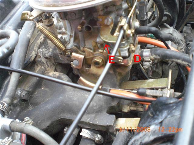

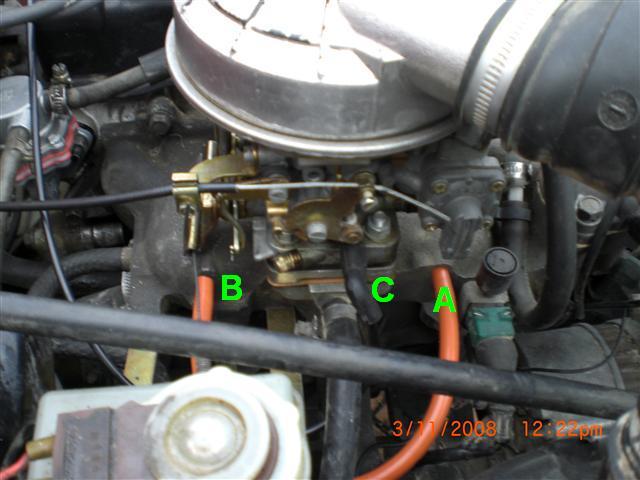

Right then
A+B are vaccum points that need to be blocked up. i had some rubber bungs but when i set my timing up wrong it blasted the ends off, so i just connected one point to the other with a piece of tubing after all they are at the same vaccum potential.
C is the vaccum advance retard, this should connect to your distributer
D is the mixture screw
E is the idle screw its hidden behind the bracket on the photo but it is there
Luke
Luke
