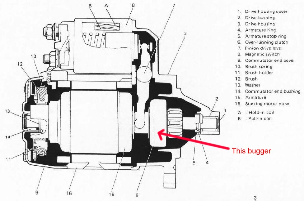

I've had what you describe. The starter turns but doesn't engage the engine. On mine the one way clutch had/was giving up and I couldn't find anybody who would sell this part. I would strip clean and inspect first as this only costs your time. Me - I got fed up with the would it/wouldn't it start game and brought a reconditioned unit
Being an old fart I remember when you could buy spares for starters and fix them yourself, but everybody just seems to sell exchange units now
- starterw.jpg (100.73 KiB) Viewed 7609 times
