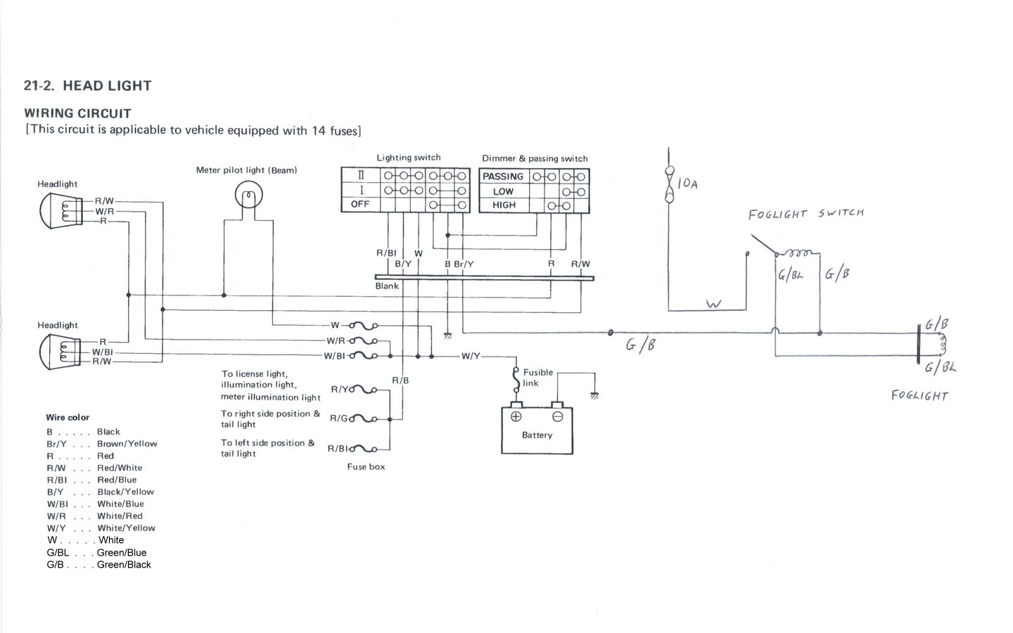

Lets start with this then. The red/white wire is from the headlight circuit which is switched earth and will read 12v via the headlight bulb until it is earthed. This is not normally connected to the foglight circuit (jap anyway). The white wire is from the fusebox. The foglight is not normally earthed at the rear and gets it's earth via the headlight switch so the foglight will only operate when the headlights are on. If you left it as it is earthed and with the green/blue connected it will work regardless of whether the headlights are on or not. Have a look for a green with black trace wire before doing much else though as you may be able to wire it up as standard. Is your foglight in the rear cluster or a separate unit.
- Headlight foglight.jpg (98.26 KiB) Viewed 8830 times

I think in they do use the red and white for the fog in the Spanish wiring though darrell? Problem is I can't find a Spanish wiring diagram anywhere, I pm'd you earlier as in this image you have posted before it shows it
Have you got a circuit diagram for the fog light that goes with this set up?
Chrisbatski how much of the donor loom have you got?
Re: maybe Someone can help fog/alternator/dash clock
I have too many diagrams. Have to see where I found that one
Not from the manual I normally use
Still haven't found it,
Scott I guess you don't want a copy unless I find that different manual.

thanks for the replys, the fog went onto the bak burner because i wanted to do the alternator but herers whar i have,
a three pin connector with a white=dead, unless i connect a random white near the fuse box to another white then it reads 12v so im guessing thats right
red/white = 12v untill the lights are switched on
green blue = switch wire to fog at rear
so if im to get this right the whits is the supply to the switch with the red/white acting as an earth so the fogs only work with headlights on and the green/blue is fog
Its a full loom i have with wiper stalks not ignition but we are linking that for now
at the moment the 2 things which i cant do are altenator and fog(which if i wanted i could wire up on another seperate switch)

fog done thanks i removed the earth on the rear and found the red/white and used that, again thanks for trhe info
just the altenator
just a quick edit fog and light on switch work fine with headlight on, but with them off the fog can still work and the light on the switch wont go off
