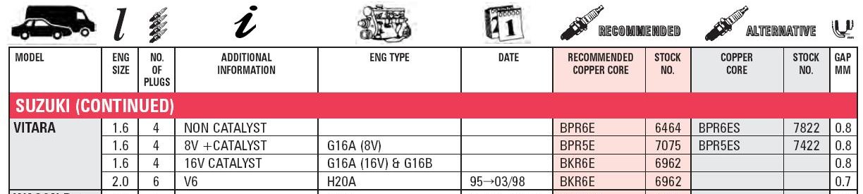

Post by Darrell » Sat Sep 24, 2011 11:09 pm
Nicked from NGK catalogue
Most sites ("googled" vitara 8 valve spark plugs) recommend BPR5ES or BPR5E.
As said best to just take a plug out and cross reference it if it's not already ngk .
Again just take your leads to a motorist shop, if they don't have a specific set they will just make a matching set off the rack.
Have a look at the air filter you already have, chance's are it will have a makers name and number on it that they can use to match that too.
