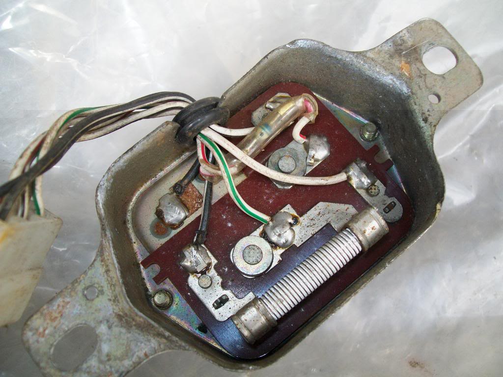

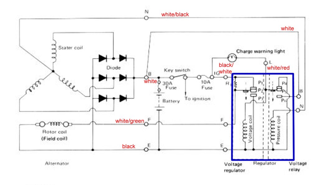

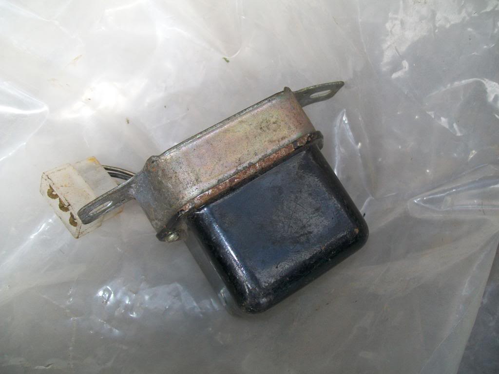

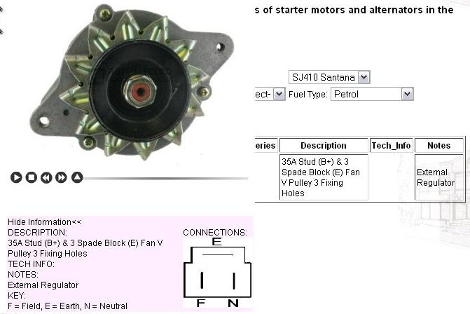

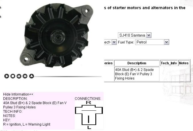

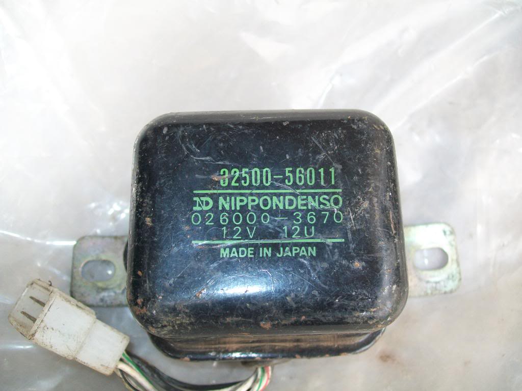

Had a look for a alternator and found this info.
84-86 models have a alternator with rectifier built in but the voltage regulator is a external separate unit.
86-93 models have a normal alternator with rectifier/regulator built in.
This external regulator is supposed to fit the early SJ and LJ models.
I have added the wire colours to a drawing from a LJ manual.
