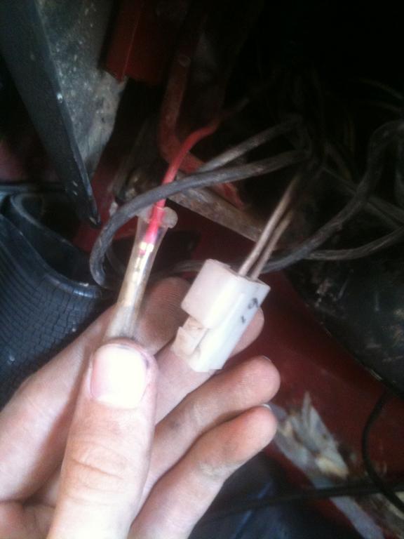

i have some wires randomly dangling around and havent a clue what they do, i also have a linwood TKA6 alarm but it seems its been wired terrably and cant find any instructions anywhere...
these two under the dash on passenger side...
these two connectors i guess they are supposed to be connected together and i think the red wire goes to the alarm just dont know what the original wires do...

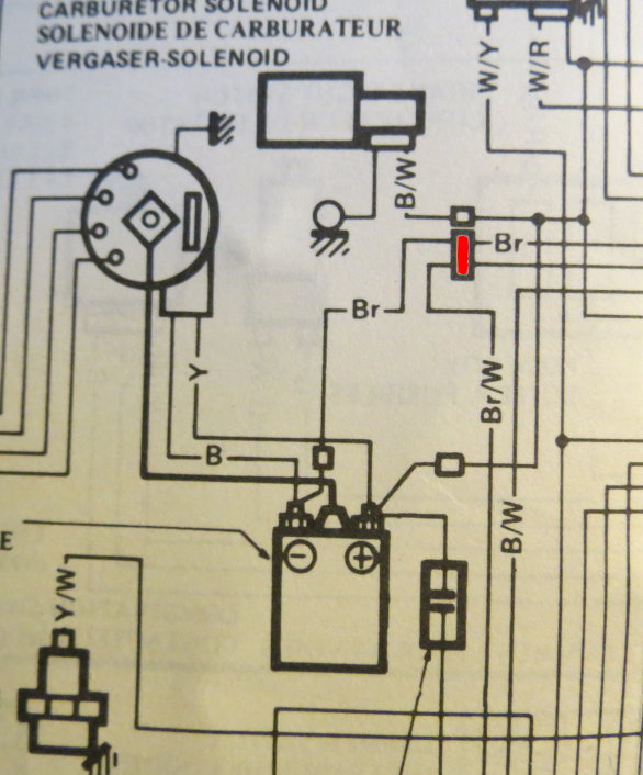

Just been and had a look at mine - I have a loose red like yours - Must have been like that for the last 12 years :D so don't worry about that.
The brown , brown/white wires go into the main loom so I cannot follow them, but the workshop manual shows a connection going to the coil for the rev counter and the idle up valve (if this is the connector in question ?) Do they both work ?
