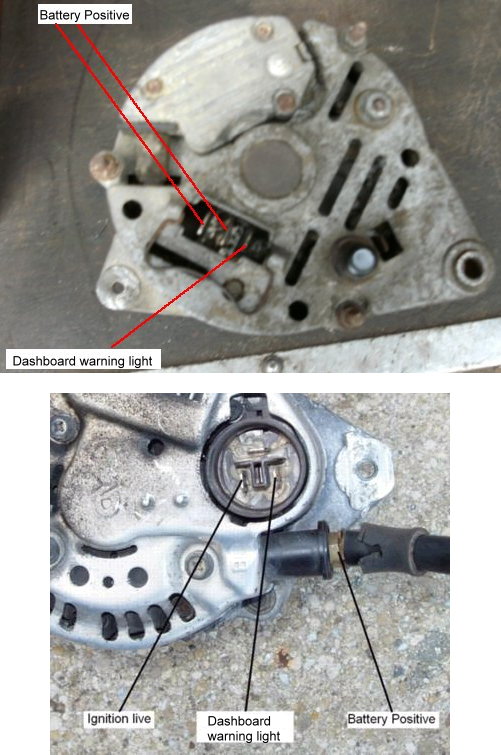

I'm almost halfway through a 1.6 conversion and today I noticed this the 1.6 alternator has a different psocket on the back compared to the one on the 1.3 alternator.
The 1.3 alternaot socket has 3 pins in a row, whereas the 1.6 alternator has one with one pin above the other 2 pointng in a different direction (I'll get some pics up tomorrow to explaine better).
How have you guys got around this. Do I need to get a new plug for the wiring, or can I just keep using the 1.3 alternator?

I just hooked up to the plug on the vit alternator.
You can use your original alternator if you wish though.

Im using the 1.3 alternator in my conversion, you just need to re-drill the crank pulley to 5 holes instead of the 4 on the SJ. Thats what I've done anyway.
Its not finished yet so cant comment on how it works but should be fine

The vit alternator would require a switched live feed from the ignition.
The two large wires just need ring terminals crimped on them.
The dashboard light just a spade crimp fitting.
Or ideally use the Vit alternator plug for those 2 wires.
I would just use the 1.3 one if it will fit easy enough ??

Just a quick note that some of the vit alternators seem to only have 1 pin in the round socket, which is for the dash light.... (well, mine does anyway!!!)

Mine has all three pins but I am only using one pin for the dash light.
Seems to work ok. What is the purpouse of the ignition live?

I'll be honest and say I don't fully understand the differences in alternators, as some have a switched supply and some don't. Basically this switched supply energises the field coils to make it work. If connected all the time the battery would go flat when it's not running. So why do some not have this set-up and the battery doesn't go flat
dammed if I know
