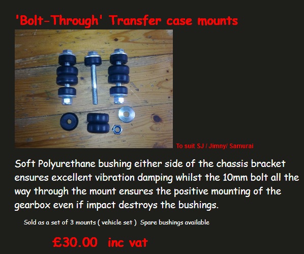

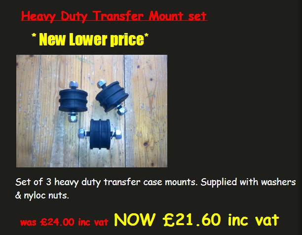

You can get a bolt through type of mounting that are stronger, but can't say if there any good or not.
I know Dave at http://www.llama4x4.com/page5.htm has them and has a good reputation.
The intermediate propshaft shouldn't be hard to find, there's a few guys selling parts in the classified section.
The 2 that Dave sells.
