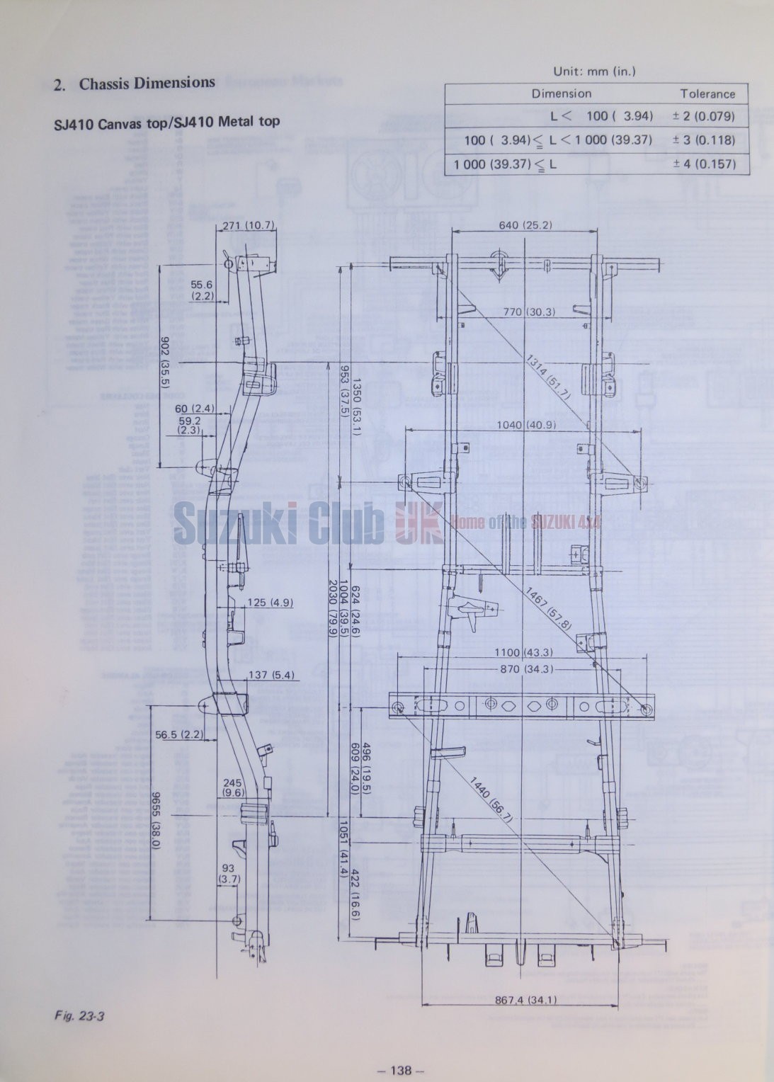

Hi Scott
It wouldn't let me send this jpeg in a PM so have posted it here. I assume it's just the gearbox mount that is different to the 413 ??
Cheers :thumbup:
SJ 410 chassis diagram.jpg (234.86 KiB) Viewed 3127 times
Sorry it's just a photo, don't want to knacker this manual getting it in the scanner ;)

Darrell that is perfect thanks! There's a few differences and I was mainly just a bit curious and wanted to see the actual one in the 410 manual :thumbup:
