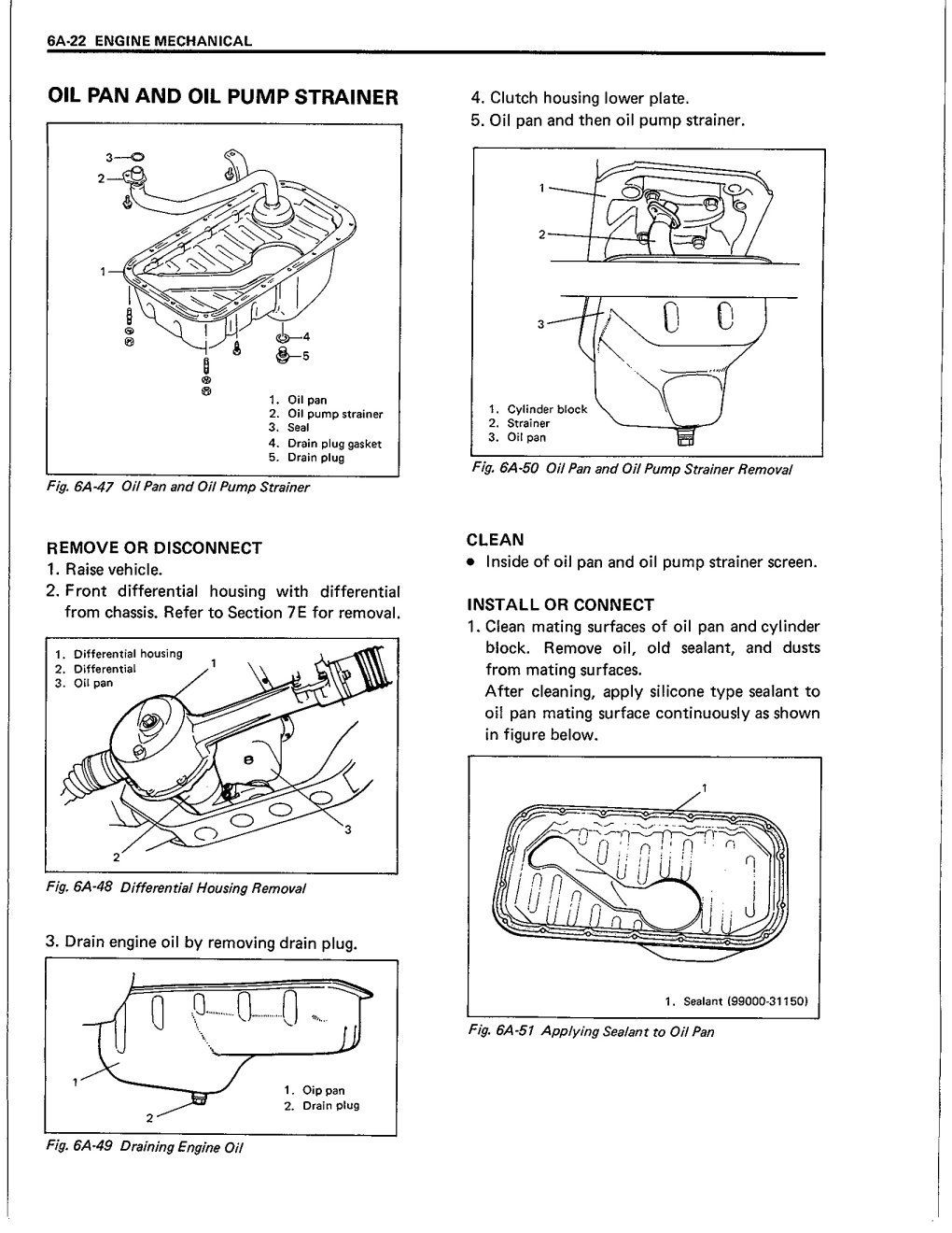

Can anyone tell me if my santana vit jx 1.6 8v single efi engine should have a sump gasket or should I use RTV? Dose it depend solely on whether there is a crank position sensor or not?
I dont think there is a crank position senso on my vit but should I use rtv or a sump gasket?

Looked at a few diagrams and none showed a gasket. This page is from a 1994 print manual.
I also looked at my grand vitara manual and that shows the same.
You can normally see cork gaskets easily enough.

Thanks for your quick reply.. I will rtv the sump.

There is no gasket, the sump is not designed to take one. I did fit one on mu 4u2 once and it just squeezed out when I tightened the sump.
