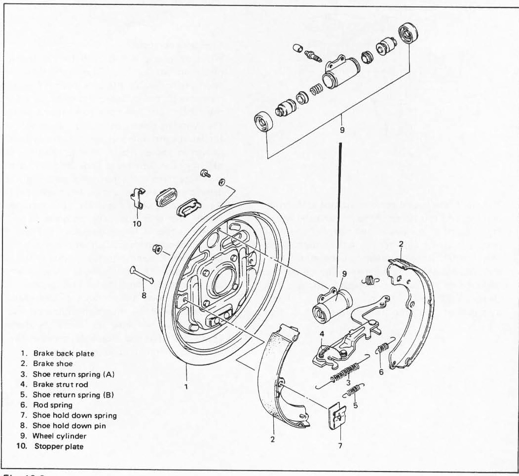

Post by Darrell » Sun Apr 14, 2013 7:07 pm
The cylinders should definitely be at the top. :shock:
If the self adjusting mech is not working it can cause this problem. (number 4)
This digram may not be correct for yours as there are a few variations, but all have the cylinders at the top.
Not sure how the handbrake cables must be routed :er: .

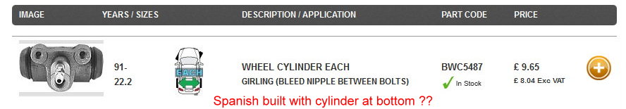

Thanks for the advice! We had a look at it and couldn't quite figure out if flipping it around would work because it didn't seem as though the handbrake cable would reach if it was flipped. In the end went to Rhino Ray who poked around in it as well and it turned out that there are two layouts of wheel cylinder. Bleed nipple between the fixing holes or brake hose entering between the fixing holes... and the ones originally on the vehicle as well as the new ones put by the other mechanic are both the wrong way round.
So I guess, the backplate being the way it is isn't necessarily a problem, perhaps it's a spanish/japanese thing? But if the cylinder is at the bottom, then the bleed nipple has to be between the fixing holes...

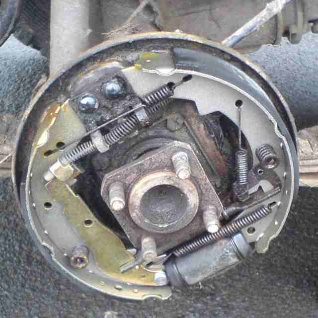

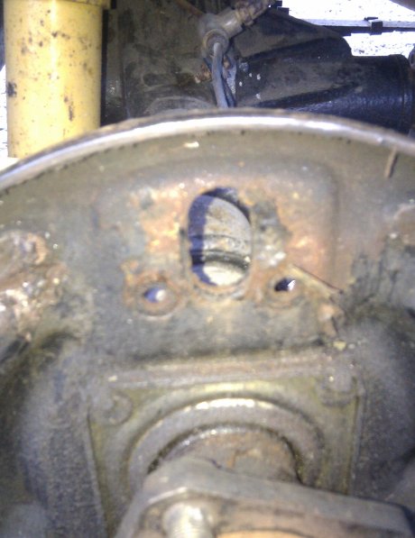

Right then after looking at all the variants and searching for pictures I have found that some Spanish built Samurai's do have the backplate around the other way. (Sorry for saying defiantly at the top, as of then I had never heard of the cylinder being at the bottom)
I have found one picture

The reason I re-searched this is because I found a cylinder listed for the samurai with the bleed nipple on the other side to normal which lead me to believe it's designed to be fitted at the bottom.
This one ??

Just imagine this backplate inverted and fitted on the opposite side.
Spanish Backplate.jpg (300.92 KiB) Viewed 10701 times

Indeed that picture is spot on, exactly how ours looks. So the problem would've occurred when at some point before we owned it, the wheel cylinders were mistakenly replaced with Japanese style ones..Then the first mechanic we went to just matched the part number and got the same Japanese style ones again, when all along it just needed the other configuration specific to Spanish built sj's... It's as if they made things confusing on purpose!
