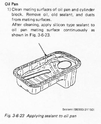

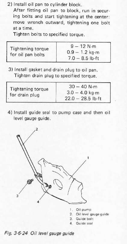

Well, had a look in the service manual, it says a slightly different method of tightening... however, there is a torque spec for the nuts
httpwww.4x4.in.thmanual_sj413chapter3.pdf - Opera_2013-05-16_16-38-06.jpg (106.97 KiB) Viewed 7519 times
httpwww.4x4.in.thmanual_sj413chapter3.pdf - Opera_2013-05-16_16-41-26.jpg (171.66 KiB) Viewed 7519 times

I wish i could say I made a mistake but I dont think I did. I tightened from the middle outwards and all were at the correct torque.
