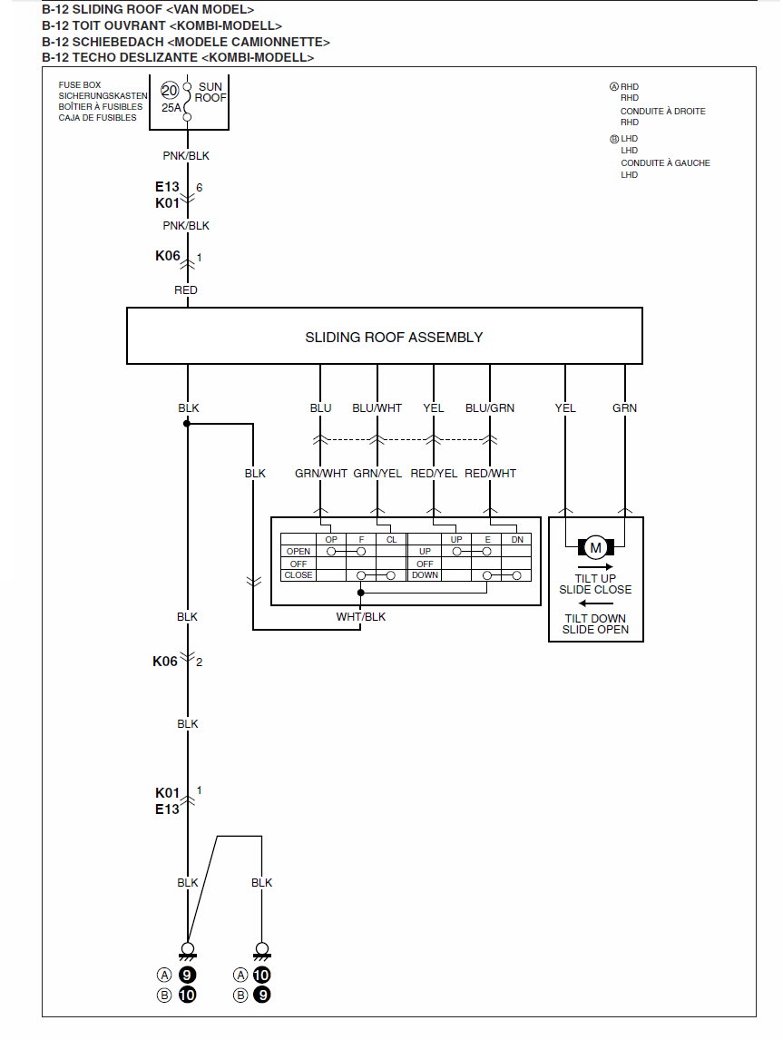

Post by Darrell » Sun Sep 08, 2013 11:11 pm
Which year and model is this ?
I can't find anything for the Vitara, only the Grand Vitara.
Here's the GV wiring anyway..
Suzuki Grand Vitara sunroof wiring.jpg (97.02 KiB) Viewed 4459 times
