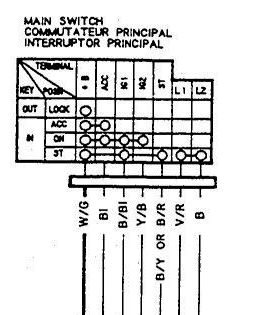

Post by Darrell » Sat Nov 02, 2013 10:31 pm
Is this the 1300 spi ? as this uses the same switch configuration as the earlier models, just the starter wire is a different colour.
Re: ignition ?
Post by Darrell » Sat Nov 02, 2013 10:33 pm
The vitara 1600 SPI ignition switch configuration is quite different though.

Post by Darrell » Sat Nov 02, 2013 10:59 pm
I should try and get another switch with key if possible.
vit switch.png (49.08 KiB) Viewed 8235 times
