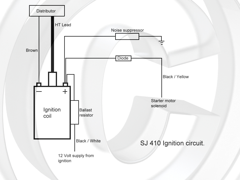

Re: help needed
Post by Darrell » Mon Nov 25, 2013 8:30 pm
:poke:
410 Ignition circuit.jpg (168.63 KiB) Viewed 6092 times
Connect 12v without the ballast resister will make it get hot.
The coil only gets 12v when cranking over.
The coil gets it's earth via the points via the dizzy.
When they open that discharges the coil via the HT lead.
Re: help needed
Post by twiss » Tue Nov 26, 2013 9:20 am
Ahhhh damn tricked by the 410 again! But as you can see there are a few wires that need to be there!
Sorry about that, my sammy has 2 wires from the dizzy to the coil, + the king lead

Post by kiwizook » Wed Nov 27, 2013 4:31 am
alright, I'll walk the walk of shame. I messed up bigtime.
so does the brown wire conect to the body of the dizzy? I suppose I can't do without the diode, as the starter will always engage? and could I test run it without the noise supressor?
