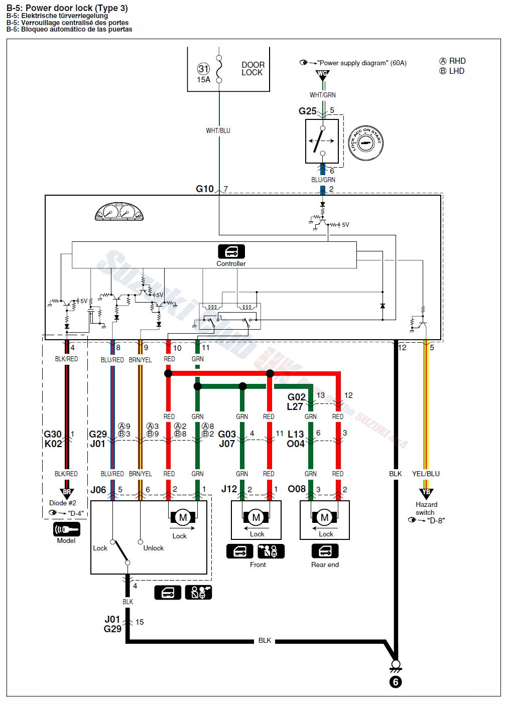

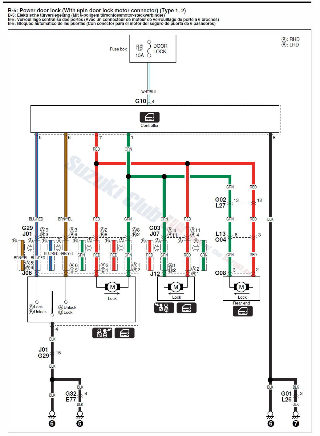

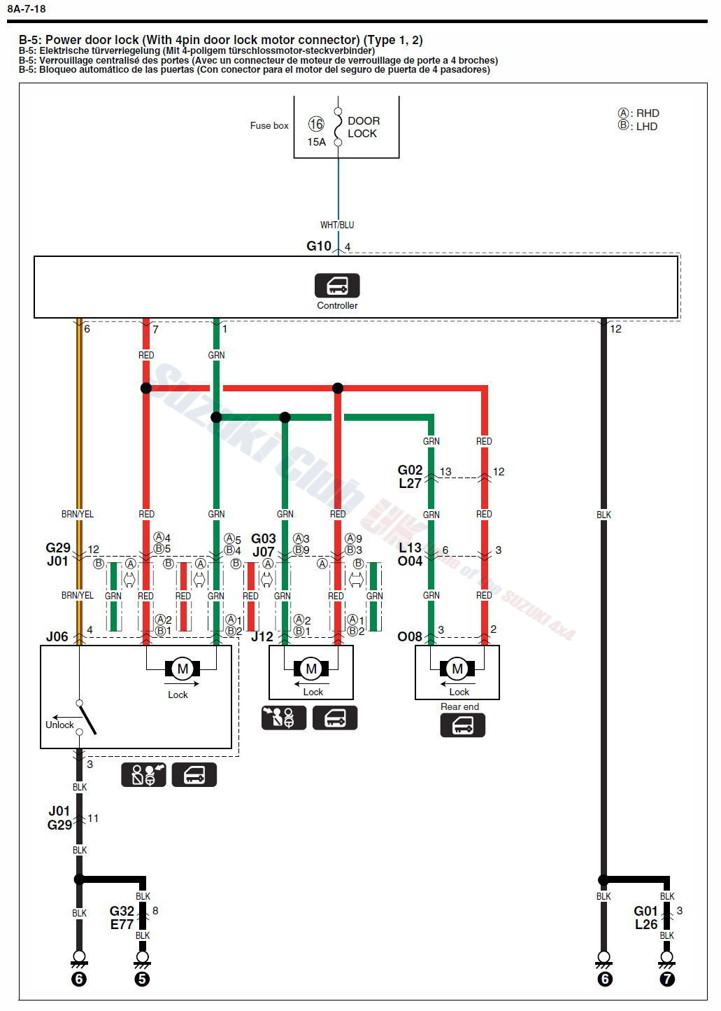

I have no idea what years have what type, but I have taken these diagrams from the manual I have.
Hope it will help.
