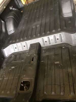

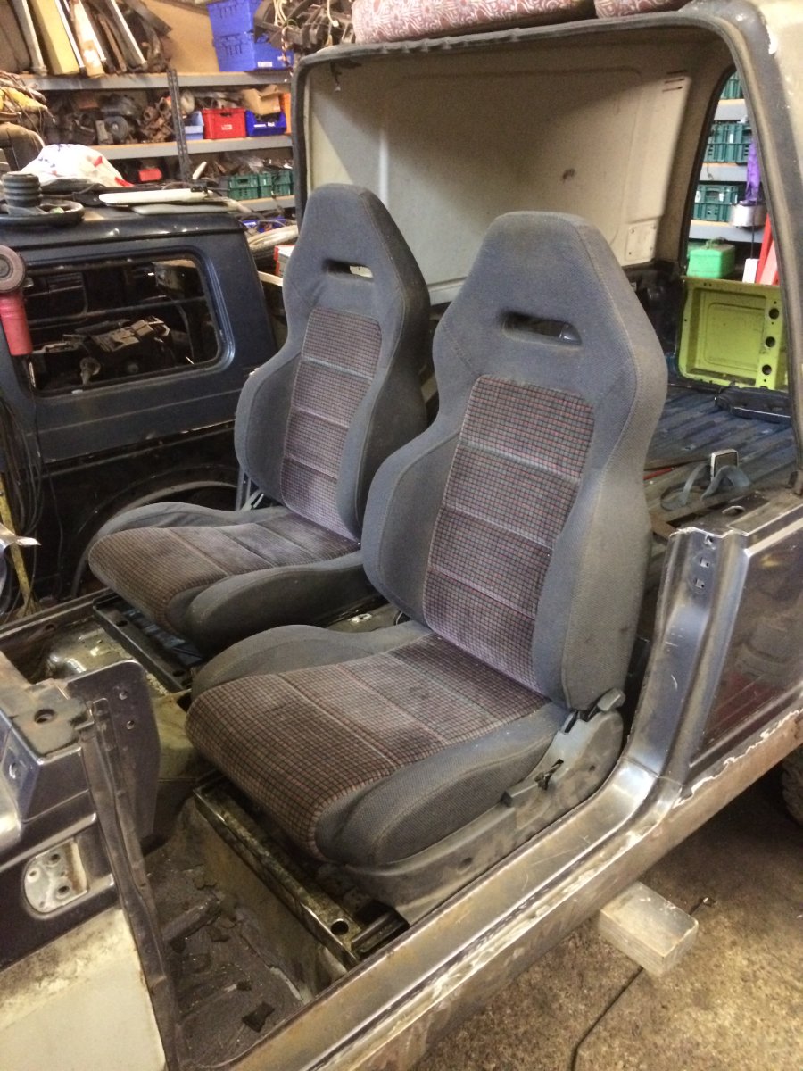

Swift Gti seats all mounted up, I am going to recover some SJ rear seats to match eventually, I have the material off the gti rear seats.

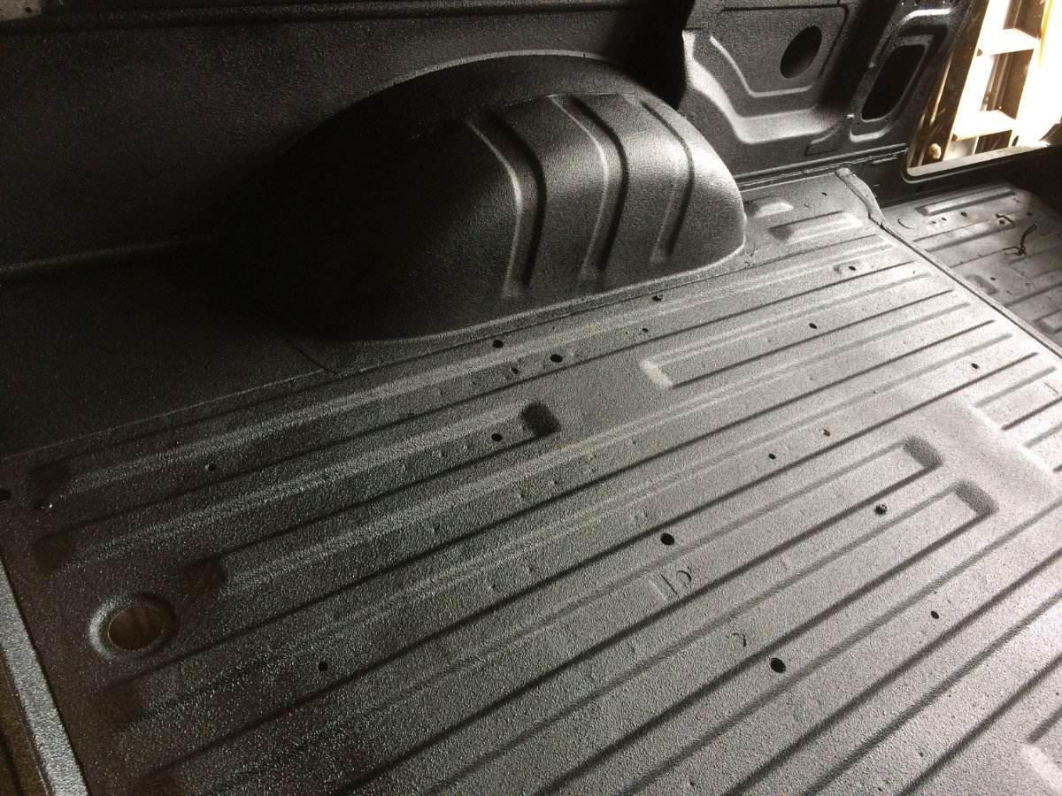

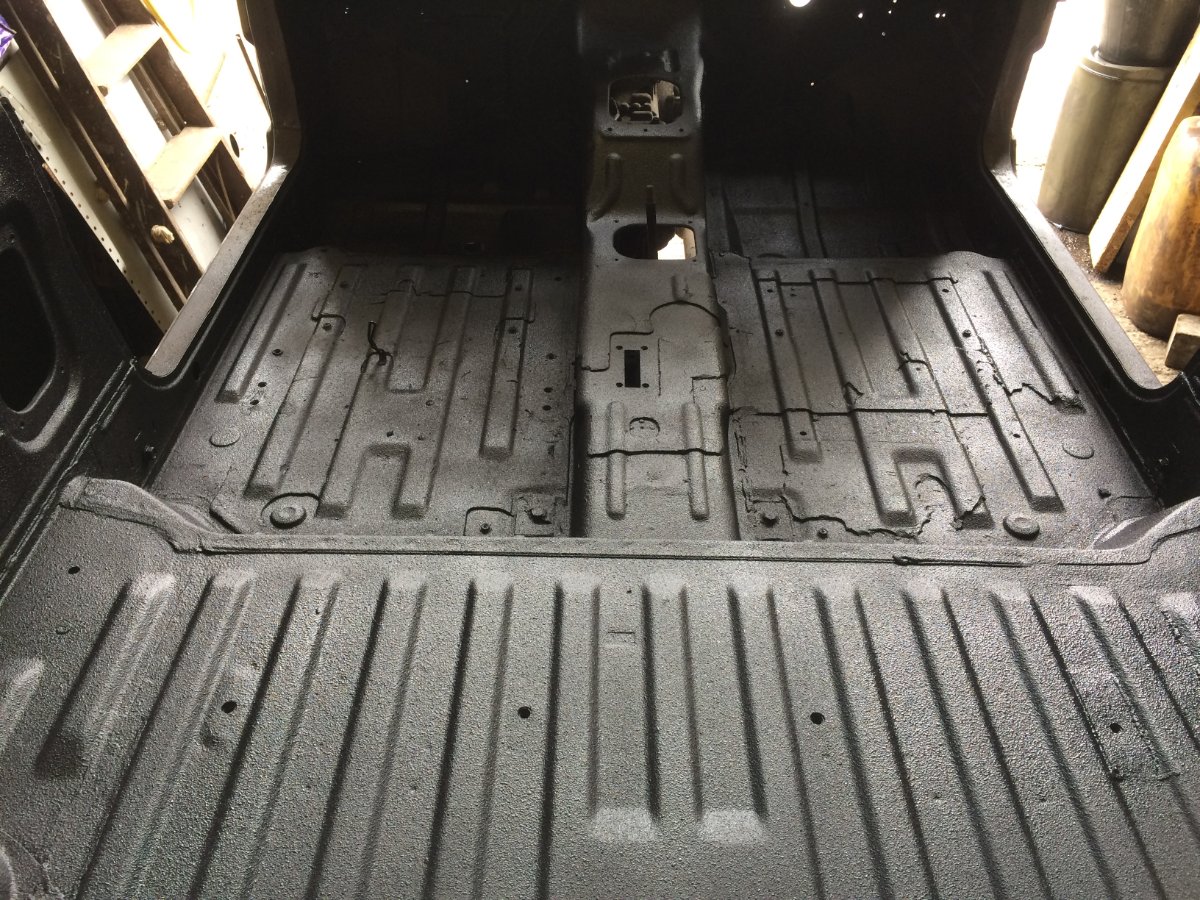

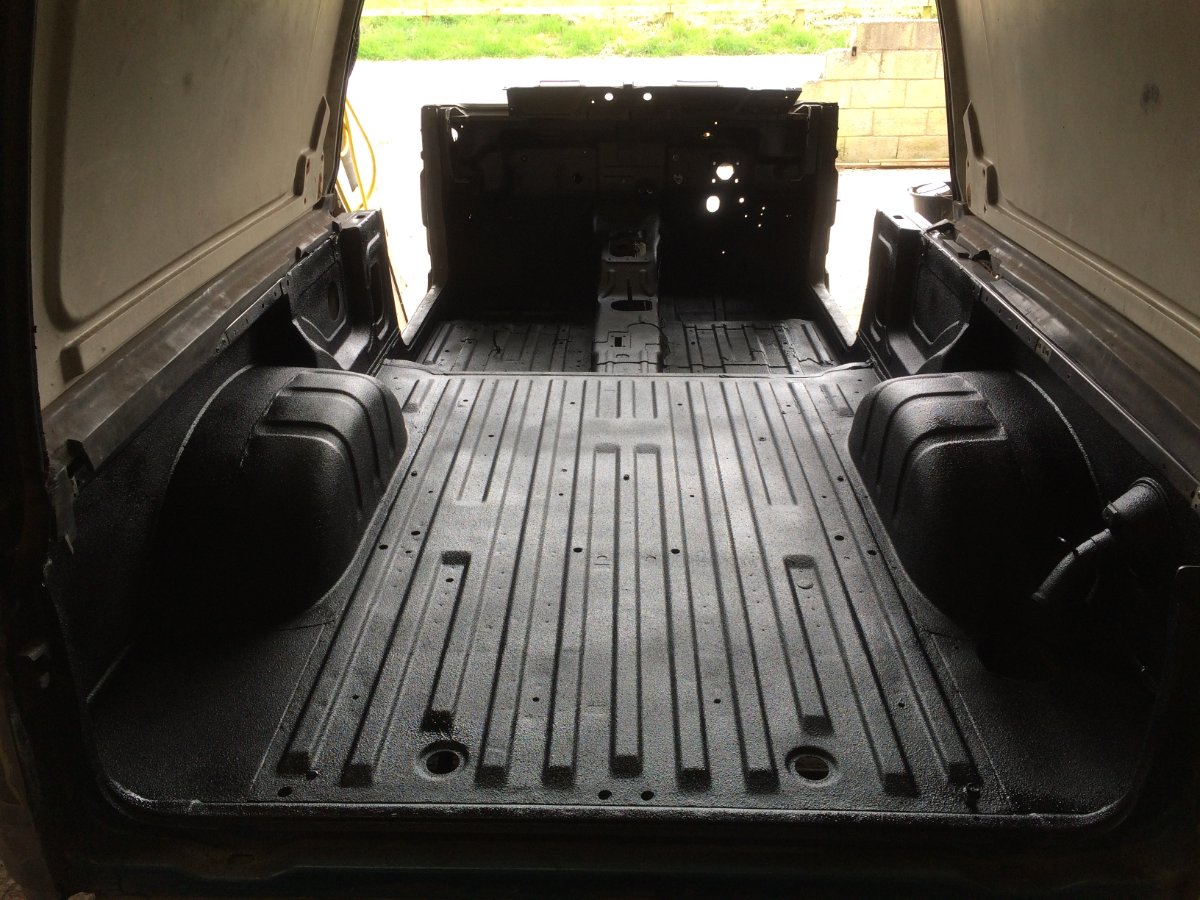

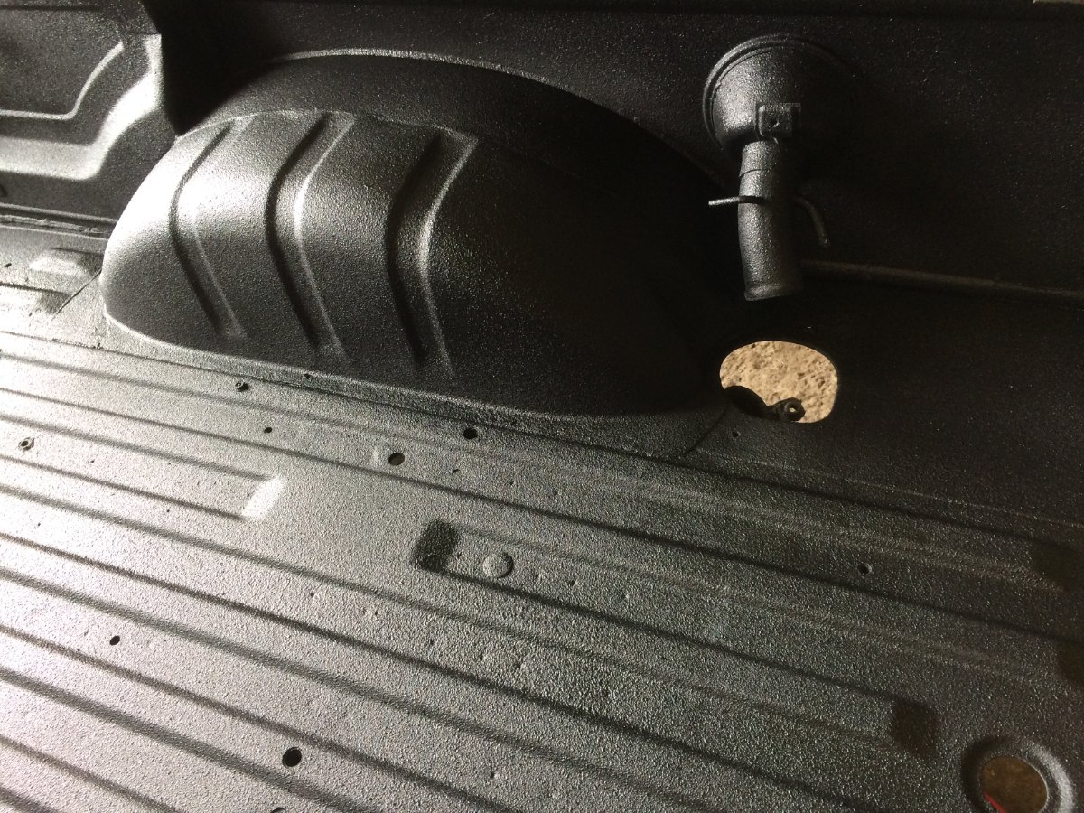

Raptor lined the inside.

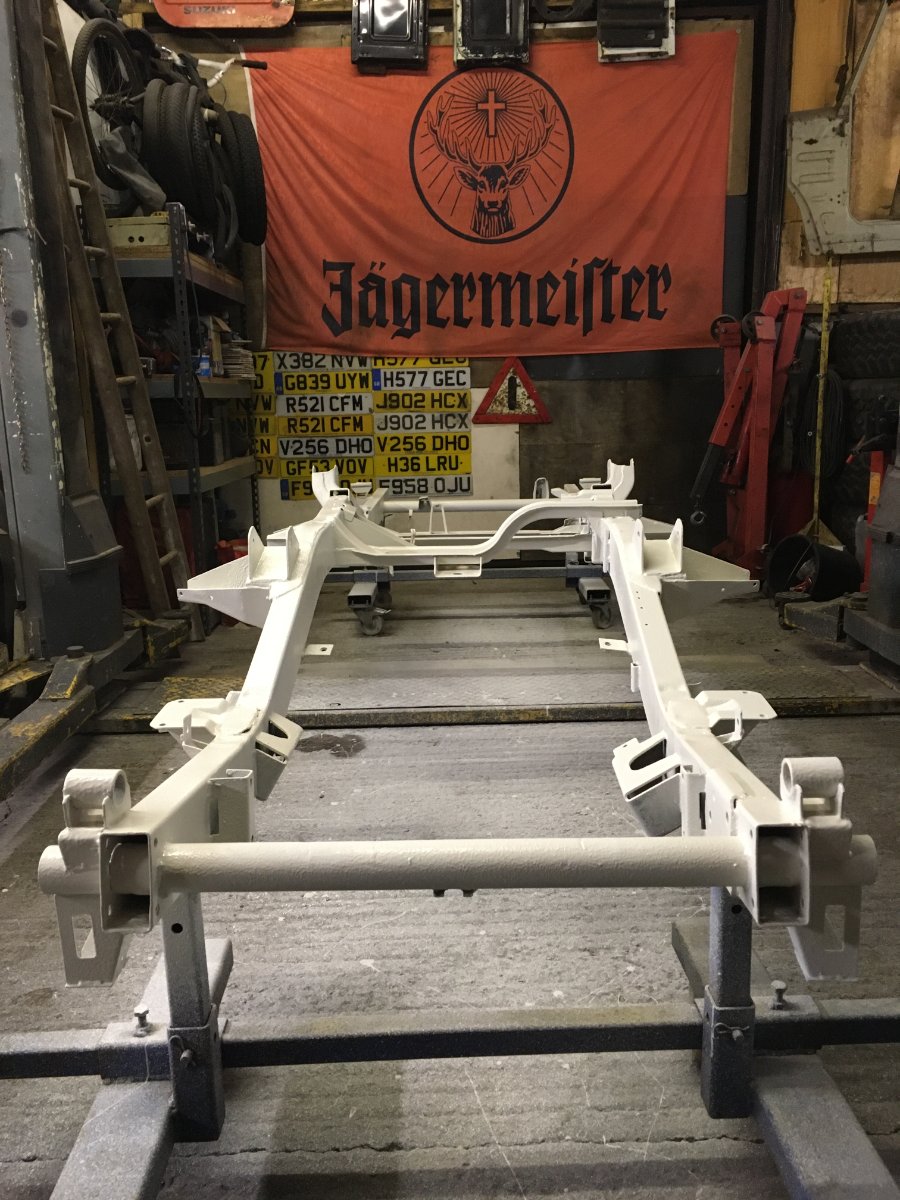

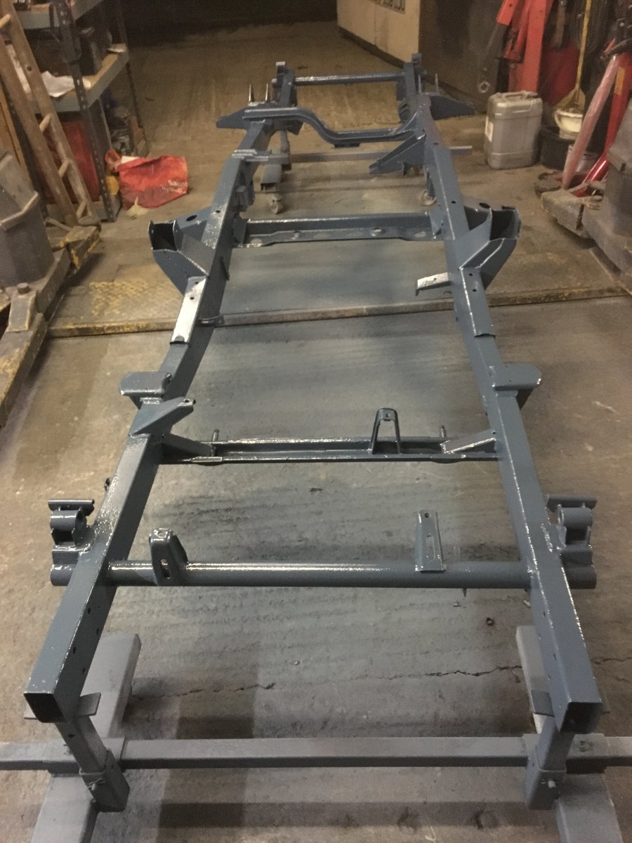

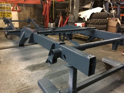

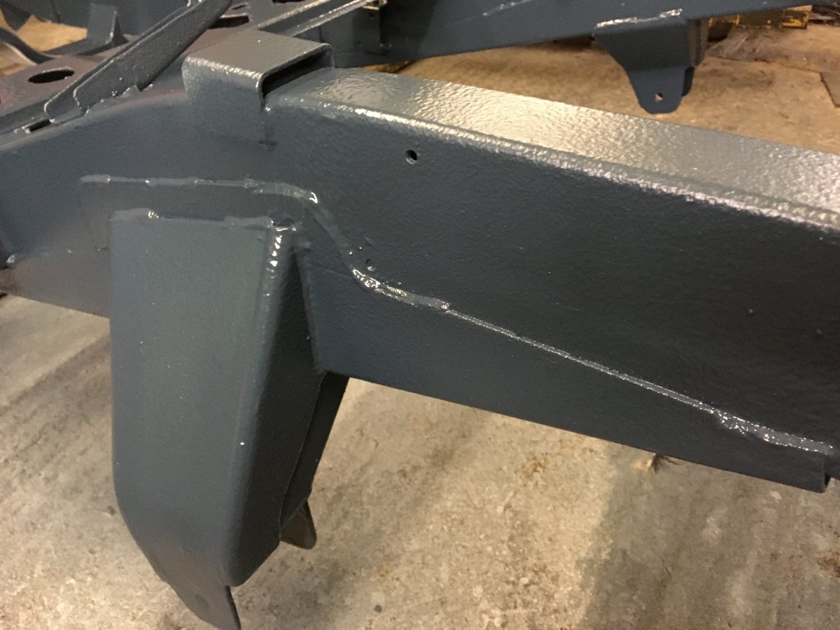

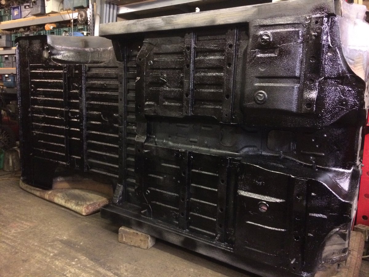

Post by ScottieJ » Wed Feb 05, 2020 11:10 pm
Just realised there has been a little bit of progress since my last post in this thread.

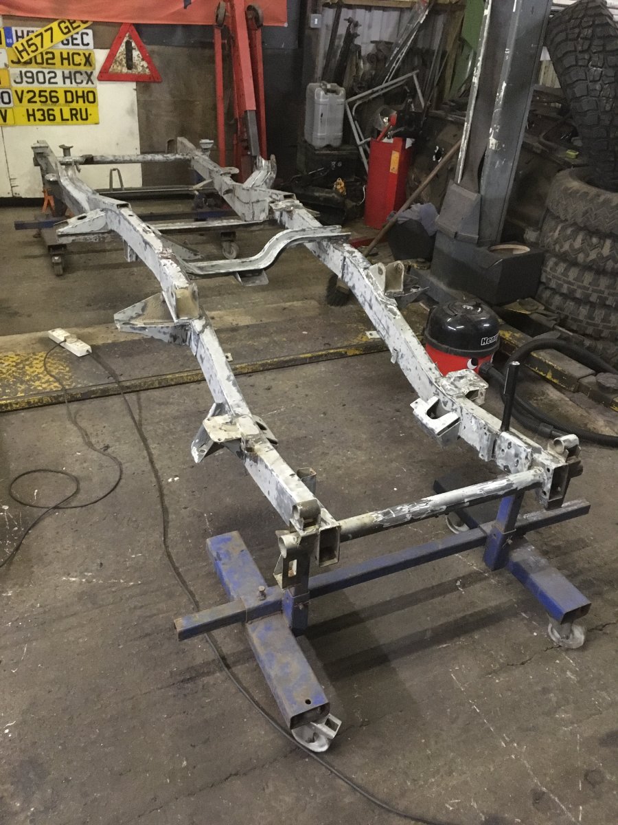

Stripped the chassis down, blasted it, etch primed, 2 coats of Upol gravitex and then body colour.

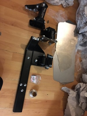

Some goodies turned up from the US to save some time with the build. Mounts and a intermediate shaft adapter to run a J20 with a 4 speed auto.
Re: Lwb daily drive and laner build
Post by donkeychomp » Thu Feb 06, 2020 10:12 pm
Nice work matey. Goodies from the US? Hope they fit, seems like 90% of the stuff they make for our cars are really awful. Hope it's not crappies from the US lol.
