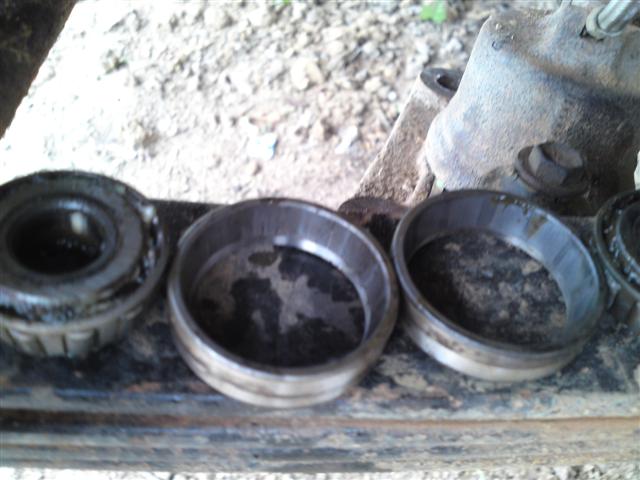

just stripped the n/s front hub and....
apart from some rotaional knotchyness in the king-pins found nothing.
wheel bearings exellent.
king -pin bearings i will change any way..
so clean re-grease reassembl..

- wheel bearing.(run face)
- Picture 052 (Small).jpg (77.2 KiB) Viewed 3975 times
