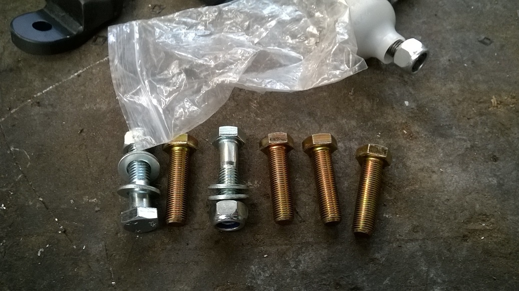

Went to put this on the other day and I'm convinced bits are missing. Stoor is being his usual arsey self and is as much help as a Bavarian unicyclists jockstrap. Has anyone got a pic of a kit fitted?

You got pics of all the bits you have?
Re: High steer kit from 'you know who'
Post by andyrew » Wed Apr 01, 2015 8:36 pm
Don't these kits mount on and replace the top king
pin? I'd assume that the kit would have 8 new bolts?
Or do they pick up on the caliper bolts like the merc arms?

andyrew wrote:Don't these kits mount on and replace the top king
Callipers bolts and existing TRE hole I think Andy.
The gold bolts are to replace the calliper mount bolts, silver ones to bolt through where the TRE used to sit.
So there should be 6 bolts, two high steer arms, a drag link and tie rod and 4 rod ends.

I just looked it up on his site.
The ones shown look like they pick
up on the kingpins. Yet mikes pick up
on the calipers :lol:

andyrew wrote:I just looked it up on his site.
Think the ones on his site are the old design that he hasn't produced for a very long time, just does the ones like mike's now.

Thanks all that was a help...looks like it IS all there!

I'm missing locking nuts for the tie-rod ends from my kit, luckily mines sat waiting for me to finish the axles!
