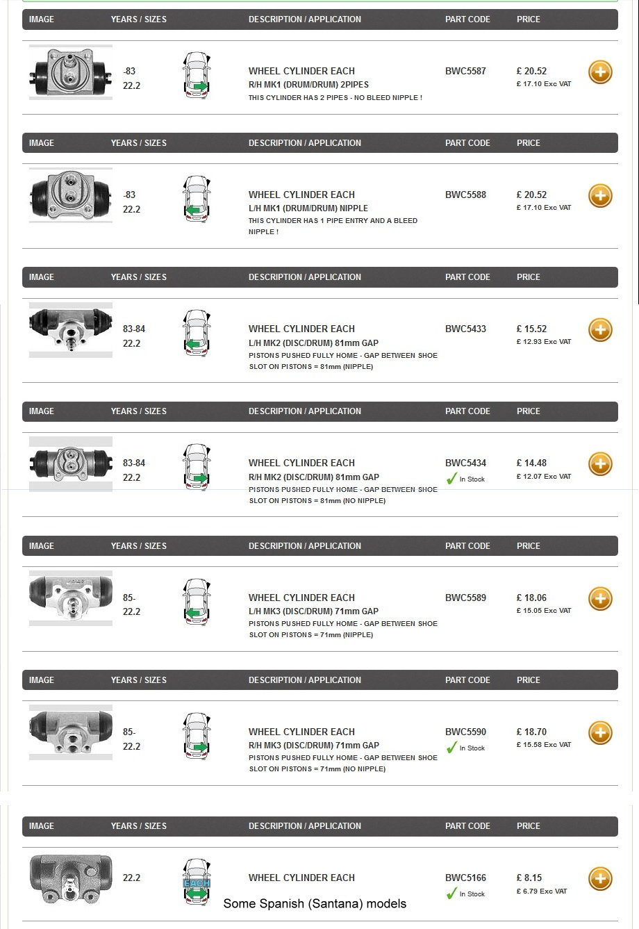

Post by Darrell » Sat Jul 18, 2015 12:15 pm
As the adjuster is on the max and you say the cylinders are fully compressed, I'd have to go with wrong cylinders. Unfortunately there are quite a few to choose from on the 410.
Info below I saved from brakesinternational and so is a few years old and no doubt the prices are incorrect.
SJ 410 rear cylinders.jpg (206.82 KiB) Viewed 6574 times
