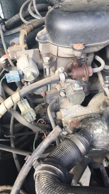

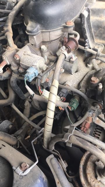

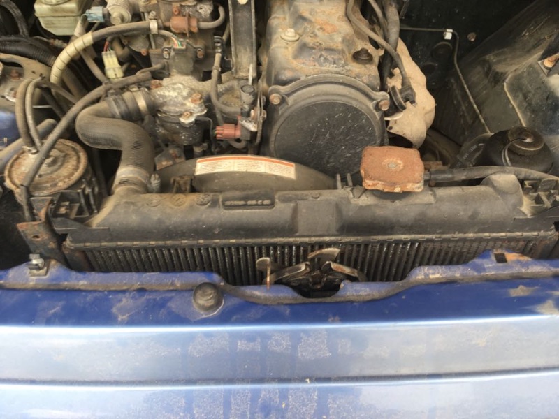

Do these motor have some fuel cut off to the ' carb' ( is it a carb or some fancy injection system ?)
had one suggestion of main power relay to the ECU...where would I find that? or does it even exist on these motors?
Totally at a loss with all this electronic shit...never seen a 'carb ' with so many connections on it

I believe that by 1999, Suzuki was using the G16B engine with fuel injection. That "carb" is probably actually a throttlebody. As such, if you lost fuel *and* spark at the same time, it's likely to be an ECU issue - but I don't know anything about ECU's. I don't even know if your ECU has an OBD2 port for diagnostics. Rhinoman is most likely to know, he's the ECU guru. Or Darrel, he's the resident wiring diagrams hero.

Yes, did wonder about that throttle body.
