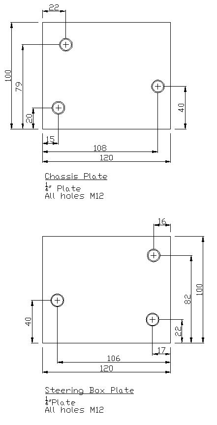

The power steering pump can go with the engine of course, but the the steering box has different mounts than the SJ. Two options are to use a jimny power steering box with your vit pump, or make an adapter wedge, have the drawing somewhere so will find it so you can see what I mean.

Didn't take long to find it.
