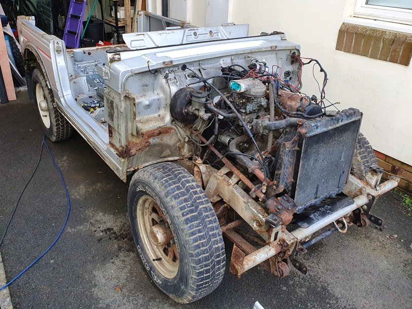

Now topless.
While there is a bit of bog on the rear corners that I'm yet to explore, the rear arches don't seem that bad. The strip that mounts the arch-guard thingos is almost completely intact.
Some resistance from some of the bolts as expected. Have had a quick look at the body-to-chassis bolts and not looking forward to trying to get them off. Mr Grinder may be needed.
Having some trouble getting the front bits off - the two strips top and bottom that sandwich the headlights. Lots of hard to spot screws in hard to reach places, and rusted to buggery.
Have cleared the wings of hangers-on inside the engine bay: airbox, wiring, etc. Hopefully tomorrow will get the front wings off, and body unbolted and jacked off the chassis. From that point I have vague plans all of which depend on how heavy the body is, and also how much it twists in the thin bit where the doors are.
I would like to make a pair of H-shaped frames around the body, so that I can store the body on its side on the drive - against the wall in the pics. I can fit the engine and drivetrain in the garage, OR the body on its side but not both. So, the plan is to sort the chassis and drivetrain first, and then put the body in the garage for welding.
After sorting the rust and welding, may send the doors/bonnet etc out for painting, as I'm not really set up for it. There is a local blast/powercoat outfit that are cheap, so will send bumpers etc to them.
Still enjoying myself. Three easy days, 18 hours total so far and good progress.

Wow you don't hang around.
Hard top... I'd fix it & keep it or sell it. They are hard to find

She's nekkid now.
That was a longer day and I admit my back is hurting a bit. Started at half 10 and finished at 8pm.
Couldn't seperate the front wings as someone has brazed the two 'joiner' bits together and it seemed easier to just pull the lot off.
I was a bit surprised to see studs on the bottom joining the chassis to the body. Studs look OK but whatever metal was sandwiched around the rubber has gone. Difficult to see what it used to look like. Have got the big washer things will reuse them.
I just sloooowly jacked up the body until it cleared the chassis, and then rolled the chassis forward and then slooooowly brought the body back down again bit by bit. It was a bit sketchy as I realised part-way through that I only had two axle stands, so I had to improvise with an old toolbox and a step-ladder. I did strain the handbrake cable a bit - will see later if it is still usable.
I was relieved at how light it was. In fact, when I realised how light the body was I felt silly for taking such exaggerated care like to was a 10 ton boat or something. I'd say it weighs 80-100kg. I was reasonably easily able to lift a corner with one hand and adjust the jack stands.
I made two skids on the body by using the studs and bolting on blocks of wood, and then screwing more wood to that until it cleared the sills. I am going to make a box frame around it and put wheels on it so I can wheel it into the garage to weld up the body. Might make a light wood frame to make wrapping it in the tarp easier.
Tomorrow is very windy and rainy so a day to work on other stuff. Hope it doesn't tip over in the wind! Have wrapped it all in tarps, but I don't have enough of them and it will be getting wet. Hey ho.
Next step will be to strip the drivetrain and engine, and then paint the chassis. Going to do as little as possible to the engine (it can wait) but it does need a new sump gasket and that rocker cover needs some love.
