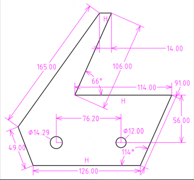

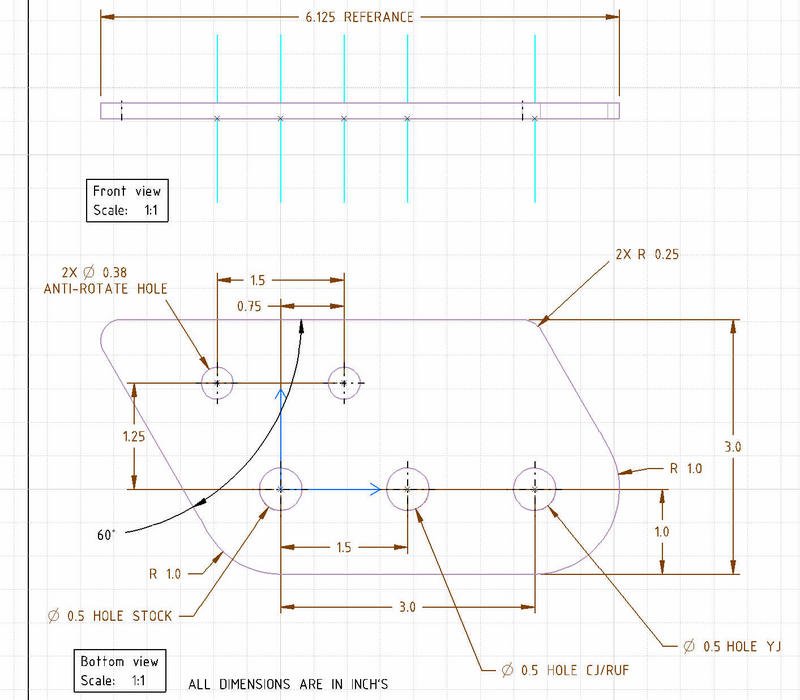

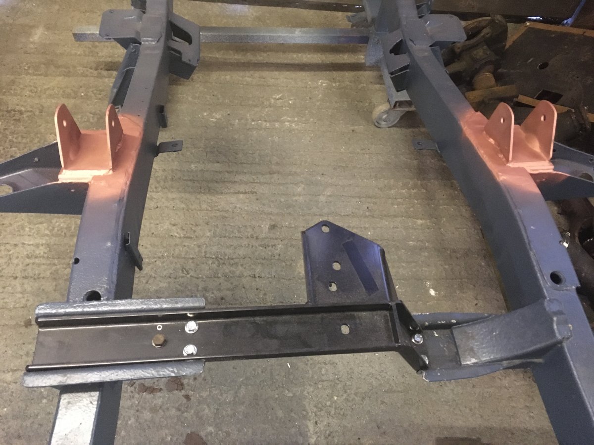

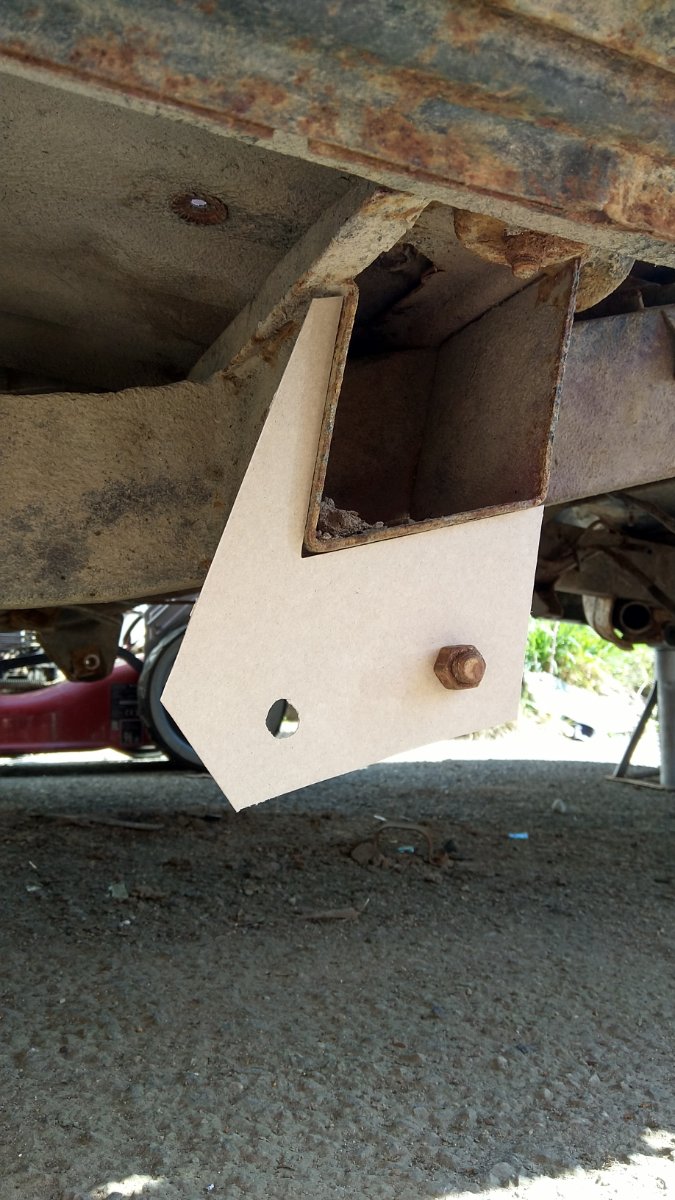

So drawn this up, think its right for the YJ rears on the Samurai. Can send PDF to anyone who would like it. Tried on both chassis and good on both. Will be making a DXF drawing this evening, with a little space between the bracket and the chassis to add a plate.
