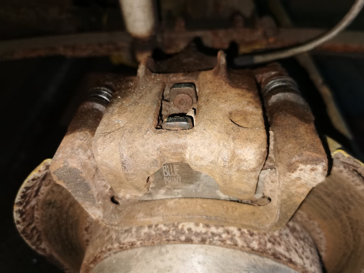

Those are Asin calipers.
I know that some Jimnys (I *think* all of them, actually) came with those exact same calipers - get a photo and maybe we can tell you.
I believe that the only difference between Jimny calipers and SJ Aisin calipers is that "Asin" is stamped on the top of SJ calipers, while that stamping is on the back (below the bleed nipple) of Jimny calipers. 99% sure they're identical otherwise, even down to using the same pads.
99% sure that's correct, but since you have Jimny calipers up front, it's easy enough for you to check.
Will take pic of front tomorrow, They do look slightly different but did take the same pads.

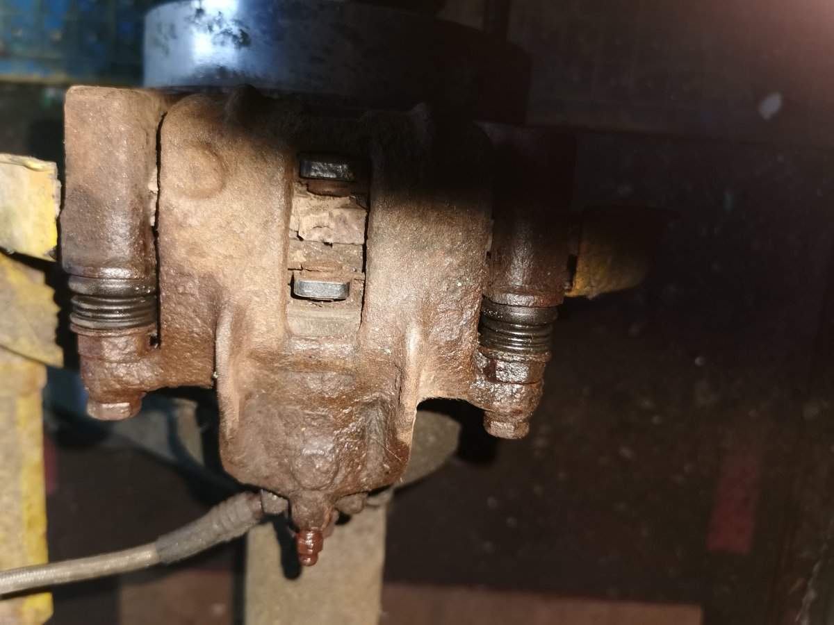

Here is pics of the ones that were on front when we got it, they took different pads and the width betewen sliders were different. to Jimnys.
Re: Calipers
Post by Anton » Thu Oct 15, 2020 11:42 pm
Those are Lucas-Girling calipers. I think they came on the Spanish built SJ's.
Replaced these on front with Jimny, which fit ,
Might have a look at the Vitara ones to see whats what.
