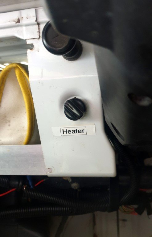

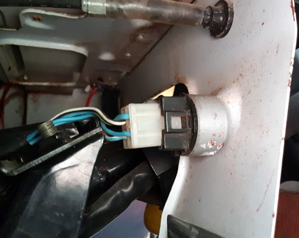

Yes, the heater resistor will be in the air flow inside the heater box. It needs to be there in the air flow as the resistor wires get very hot. The photos show all there is behind the switch is the connector to the fan unit. The plastic dash was removed about 20 years ago and trays made in the empty space to vastly increase storage area.

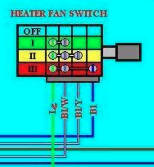

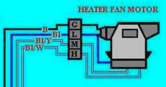

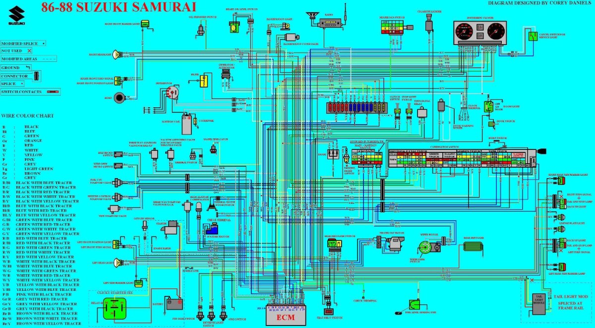

Attached is a wiring diagram detail of the heater switch and fan connections I think I got from this site for a 86-88 Samurai - the drawing was by Corey Daniels. Lg is light green - goes to a 15A fuse. You could try briefly putting 12v positive directly onto the positive fan terminal. The negative one is connected to the body. This would test if the fan motor itself is OK.
