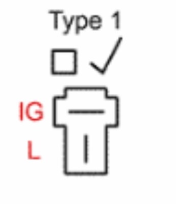

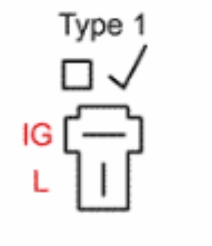

Thanks Scottie that's great, i don't suppose you know to convert to the new type with internal regulator ?
Posts: 11713
Re: Wiring diagram
Post by ScottieJ » Wed Jul 02, 2025 10:45 pm
You’ll just need to wire up the thick white wire to the + stud as usual.
IIRC the later jap ones have a type 1 style plug so
White-red that goes to the voltage reg is the warning light hook that up to L
And
Black-white to IG
The other wires aren’t needed. Make sure the white at the old voltage regulator plug is insulated though to avoid any shorts as that will be a permanent live.
