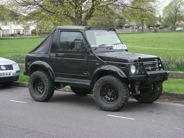

Re: 235/75/15
Post by Edweird » Wed Jan 04, 2012 6:52 pm
You could almost get away with 235/75/15 without a lift couldn't you? You'd get some rubbage on lock so you'd need to do something about that.
Re: 235/75/15
Post by Tramp » Wed Jan 04, 2012 8:47 pm
I run 235/75r15, I have a calmini 3.5" lift, its just right for the tyre size with no rubbing
Re: 235/75/15
Post by twiss » Wed Jan 04, 2012 9:17 pm
I have 235x75r15 Kumho KL-71s on standard wheels... with about 2.5-3" lift, and wheel spacers.
I wouldn't really recommend it without wheel spacers, you will probably rub your springs on full lock
I think 3-3.5" lift is best with them as you have some room for articulation!
